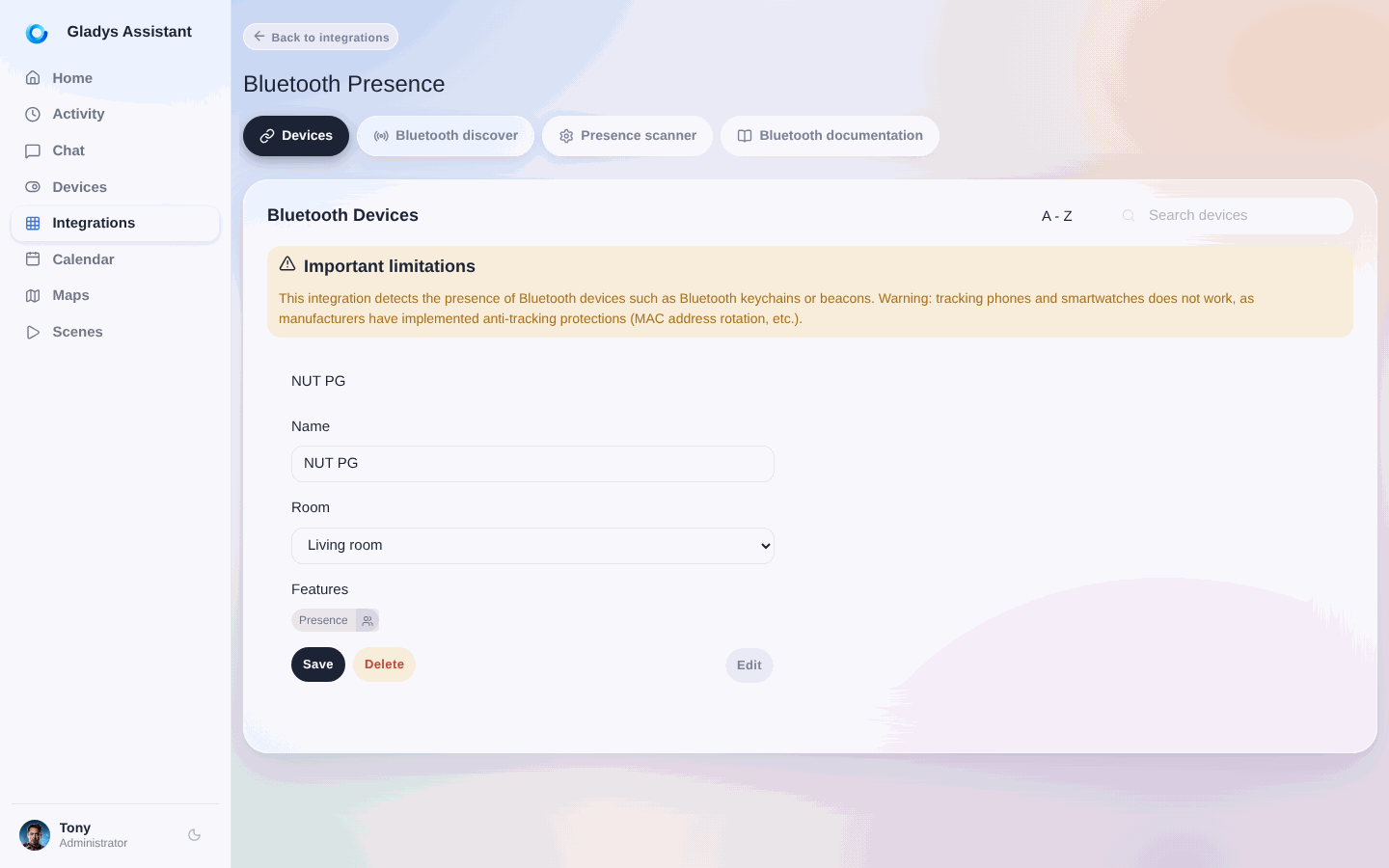

Go to the "Bluetooth" integration, "Discovery" tab. Scan the surrounding bluetooth devices, and find the device you want to add.

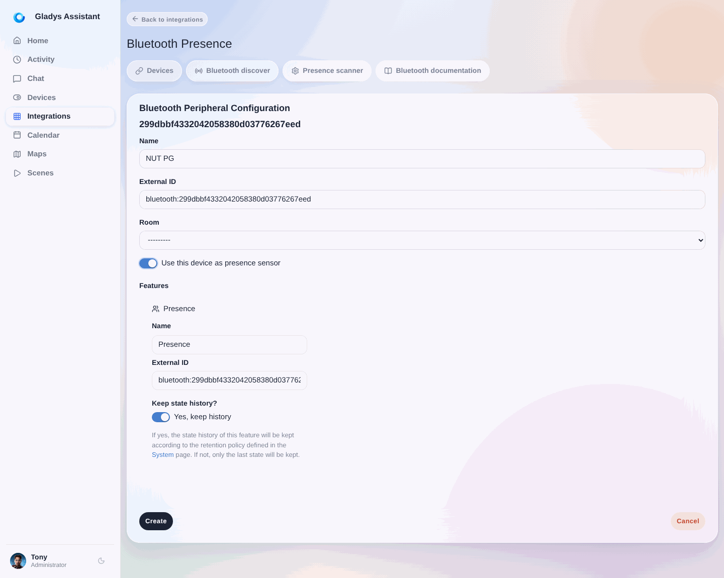

Click on "Connect to Gladys":
Configure bluetooth device
Then activate the option "Use this device as a presence sensor".
Give this device a unique name, and add it to Gladys.
You should land on this screen:

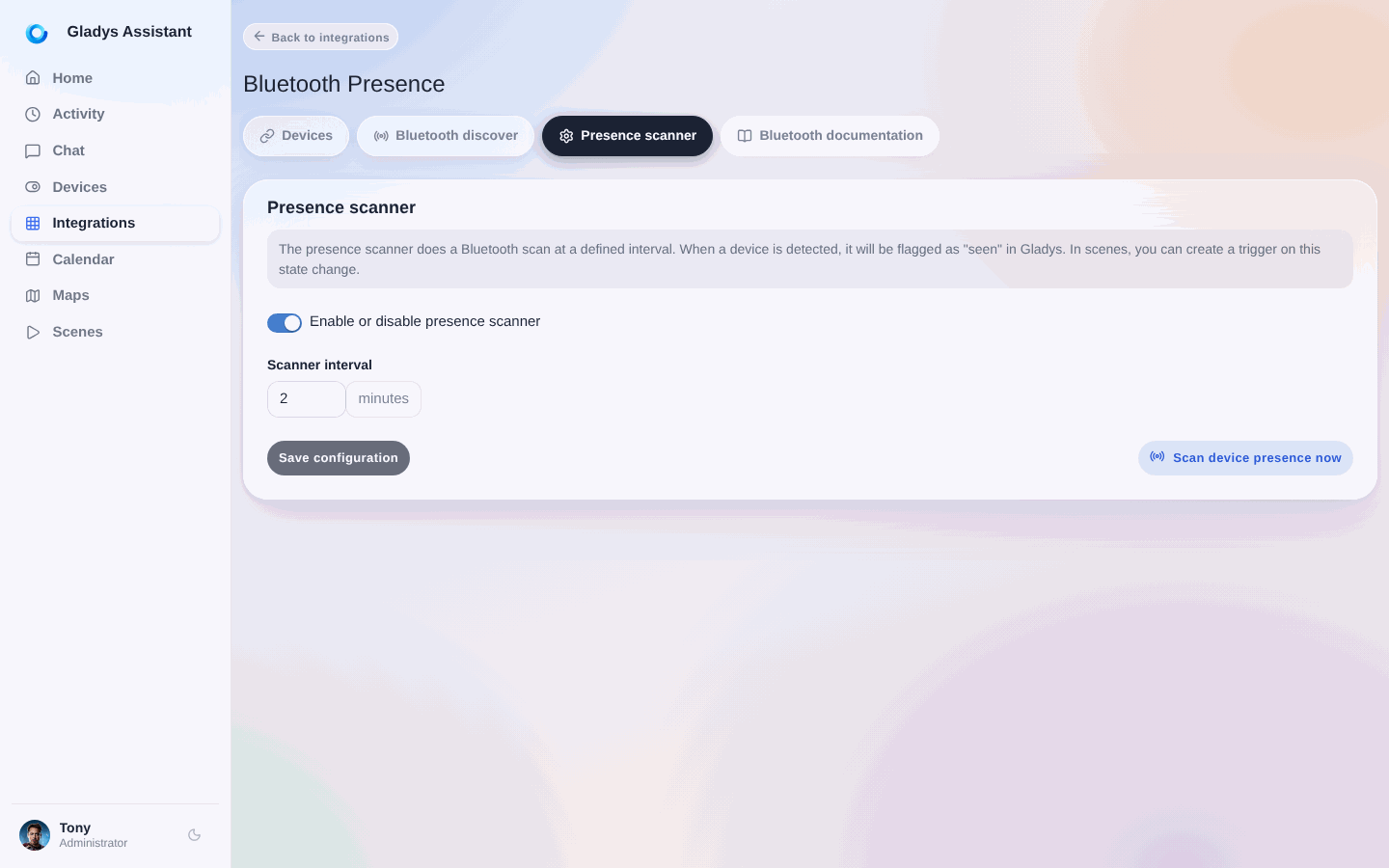

Now, go to the "Presence scanner" screen, and check that your configuration looks like this:
It's good, everything is configured on the Bluetooth side!

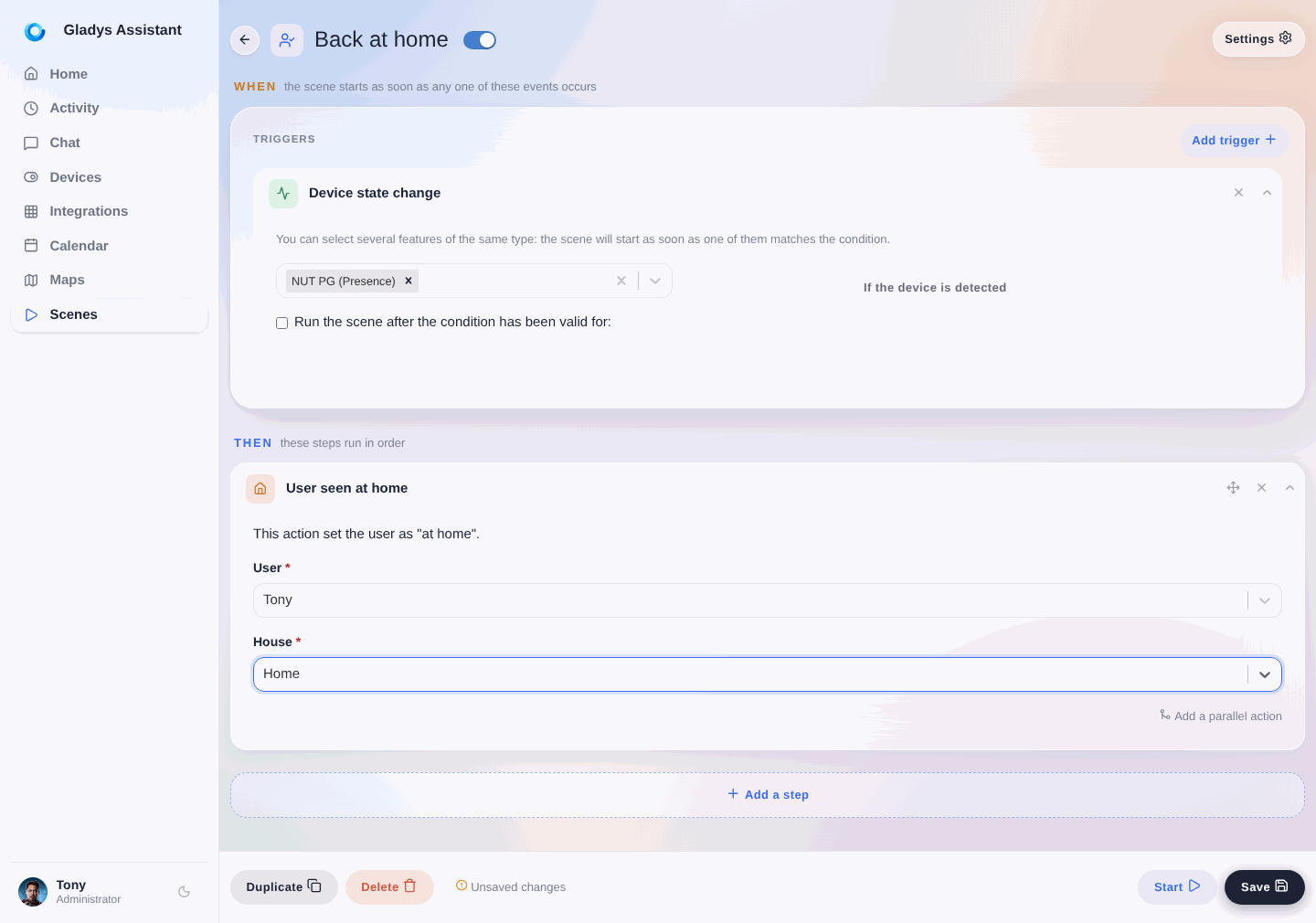

We are now going to create a scene that will mark a user as "present at home" when this Nut keychain (or any other compatible bluetooth device) is detected.
Go to the "Scenes" tab, and create a scene like this:
Return home scene
The scene is very simple.
WHEN "the key fob is detected" THEN "put user 'Tony' as present at home".

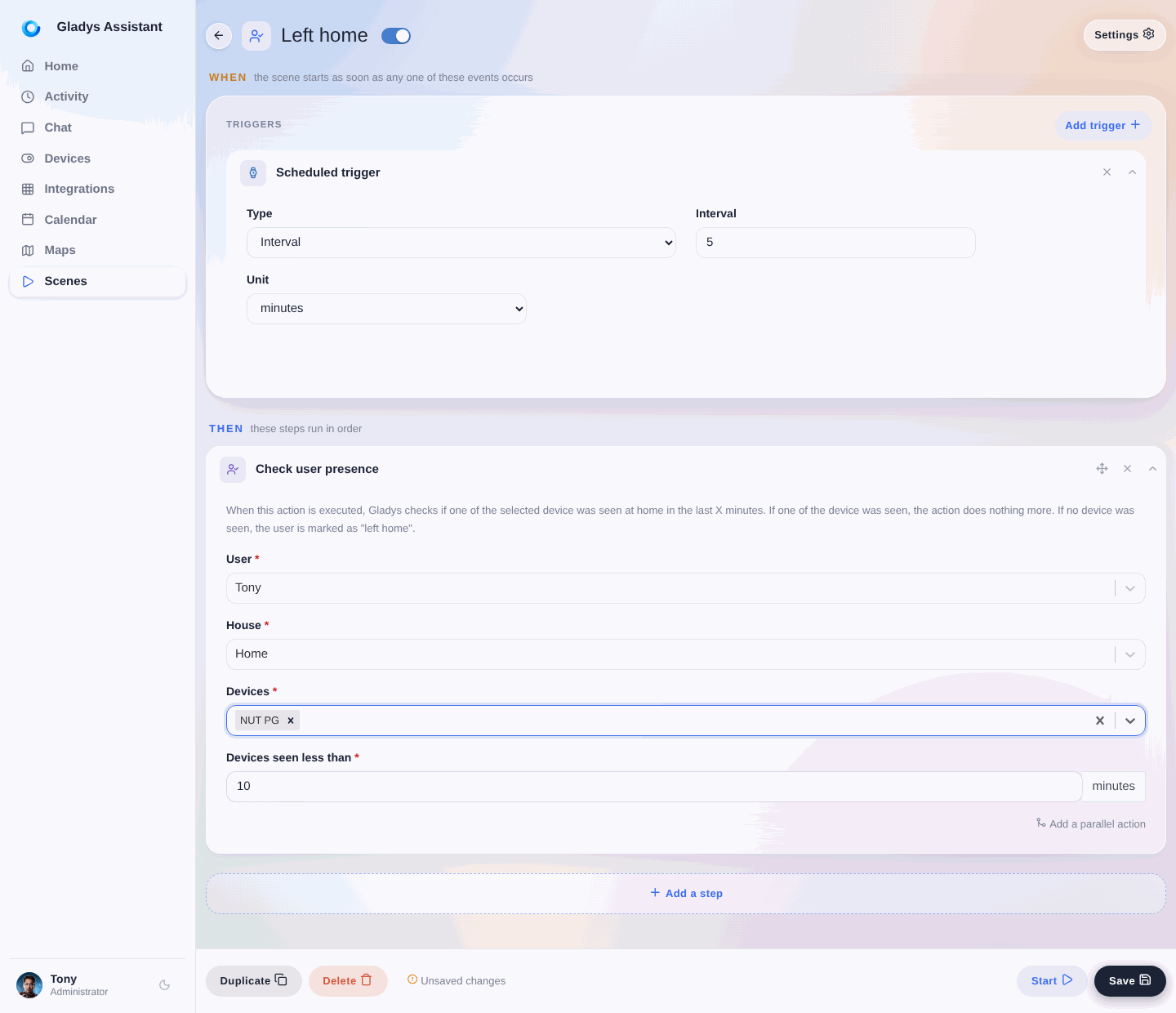

To manage the departure of the user from the house, we recommend you make a scene executed periodically, which will check if your NUT keychain has been detected recently at home.
If Gladys detects the device's presence, it won't do anything. If not, Gladys will mark the user as absent.
The scene should look like this:
Scene leaving home
You can play around with the settings to suit your home. If you feel that 10 minutes is too short to be put as absent, you can extend it to 20 minutes to avoid "false positives" 😀
