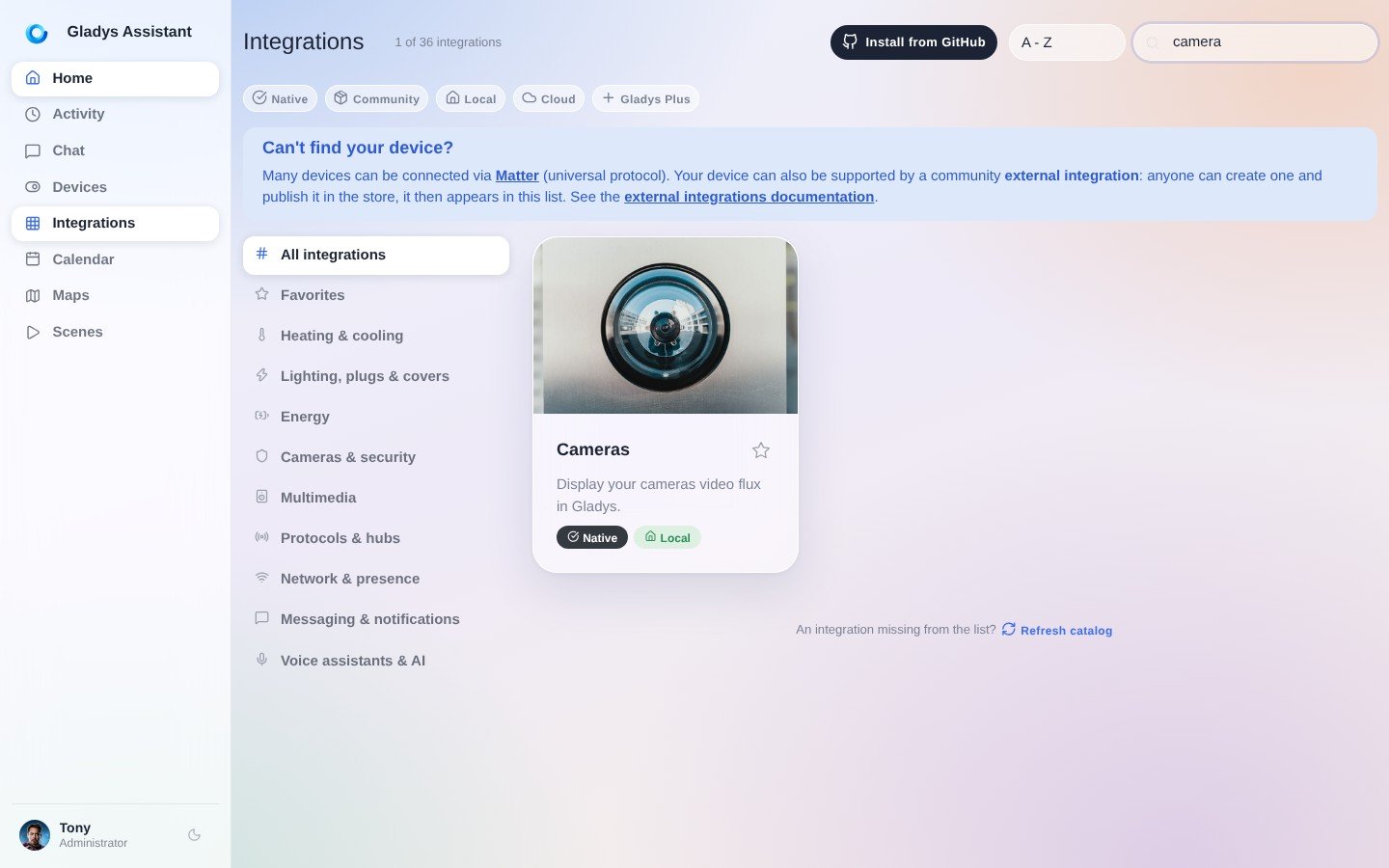

Go to the "Integrations" tab in Gladys, then click on the "Camera" integration:
Add a camera to Gladys Assistant

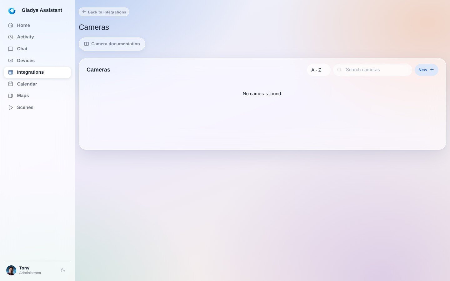

Click on "New"

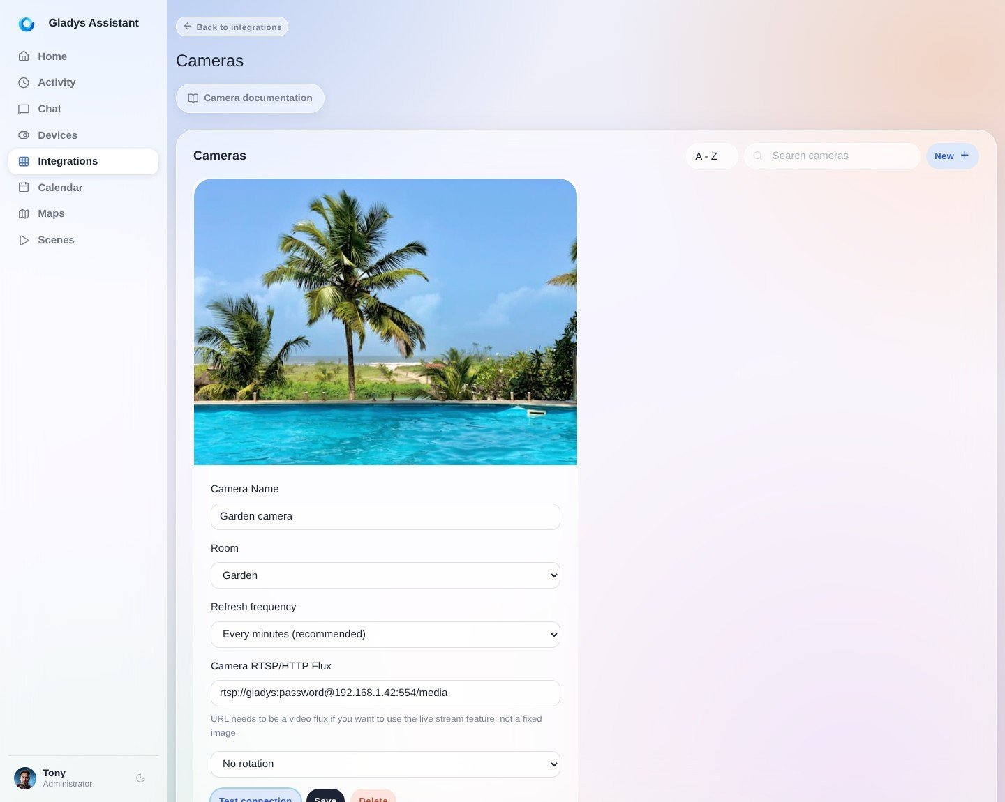

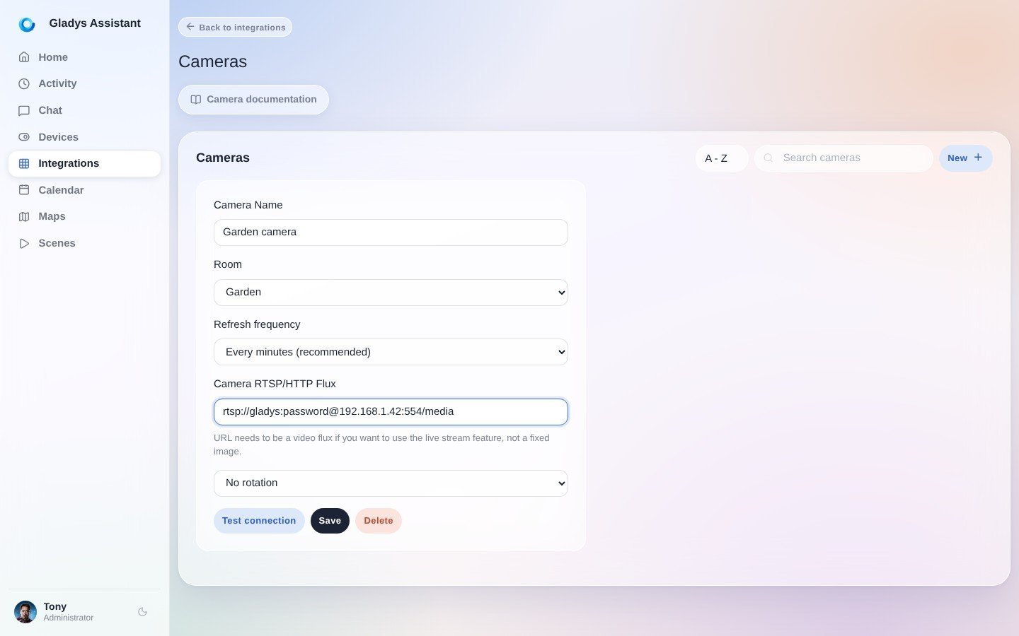

Fill the form
You can then try the stream by clicking on "Test connection". If it doesn't work, are you sure that your Gladys hardware is on the same network as your camera? Are credentials correct?
Then, you can click on "Save".

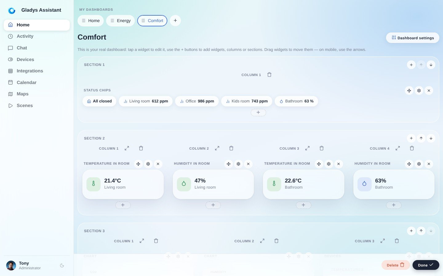

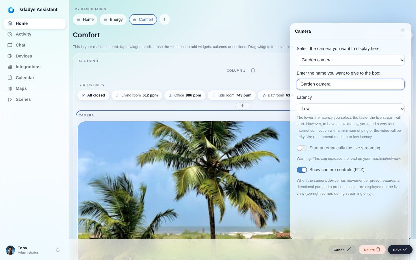

Add your camera to Gladys Assistant dashboard
Go to the Gladys dashboard and click on "Edit"

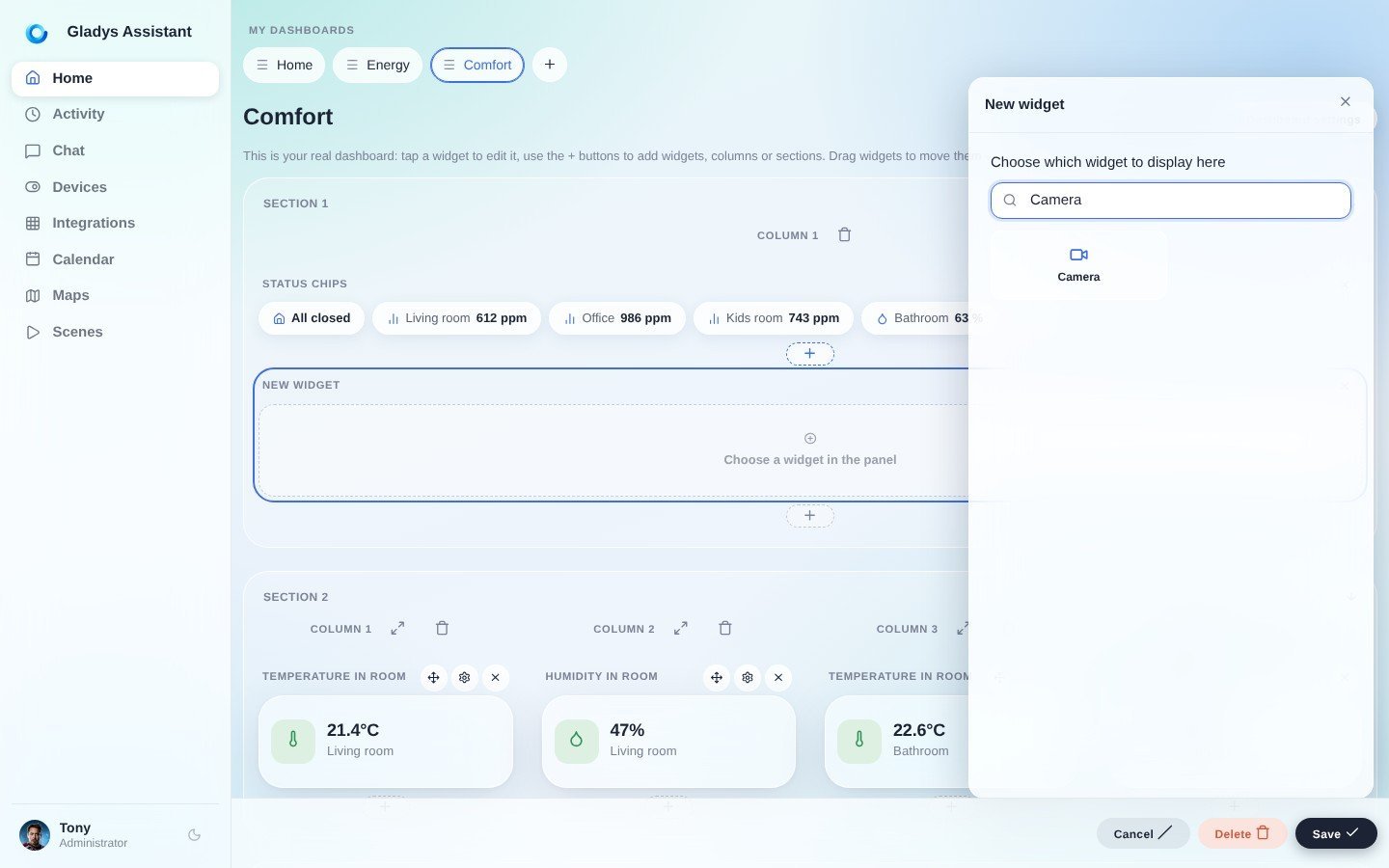

Click on "+", then choose the camera box
Select your camera, then click on "Save"
Voilà ! Your camera should be visible.

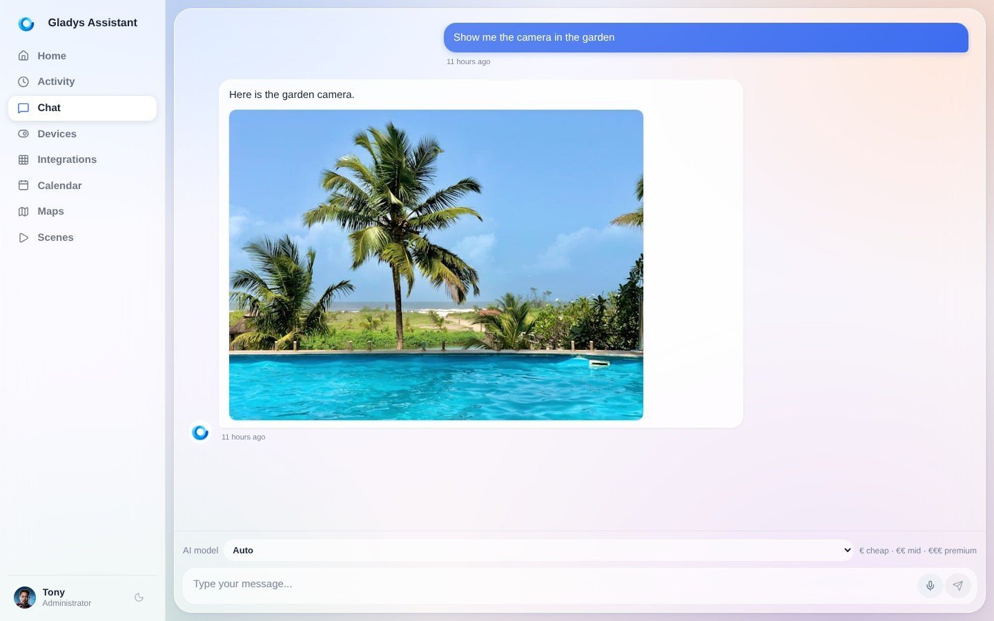

Send a message to Gladys Assistant to see a camera image
Go to the "Chat" tab, and ask Gladys "Show me the camera in the XXXX" (where XXXX is the room where the camera is)
And... magic!
Ask for a camera image in Gladys Assistant
