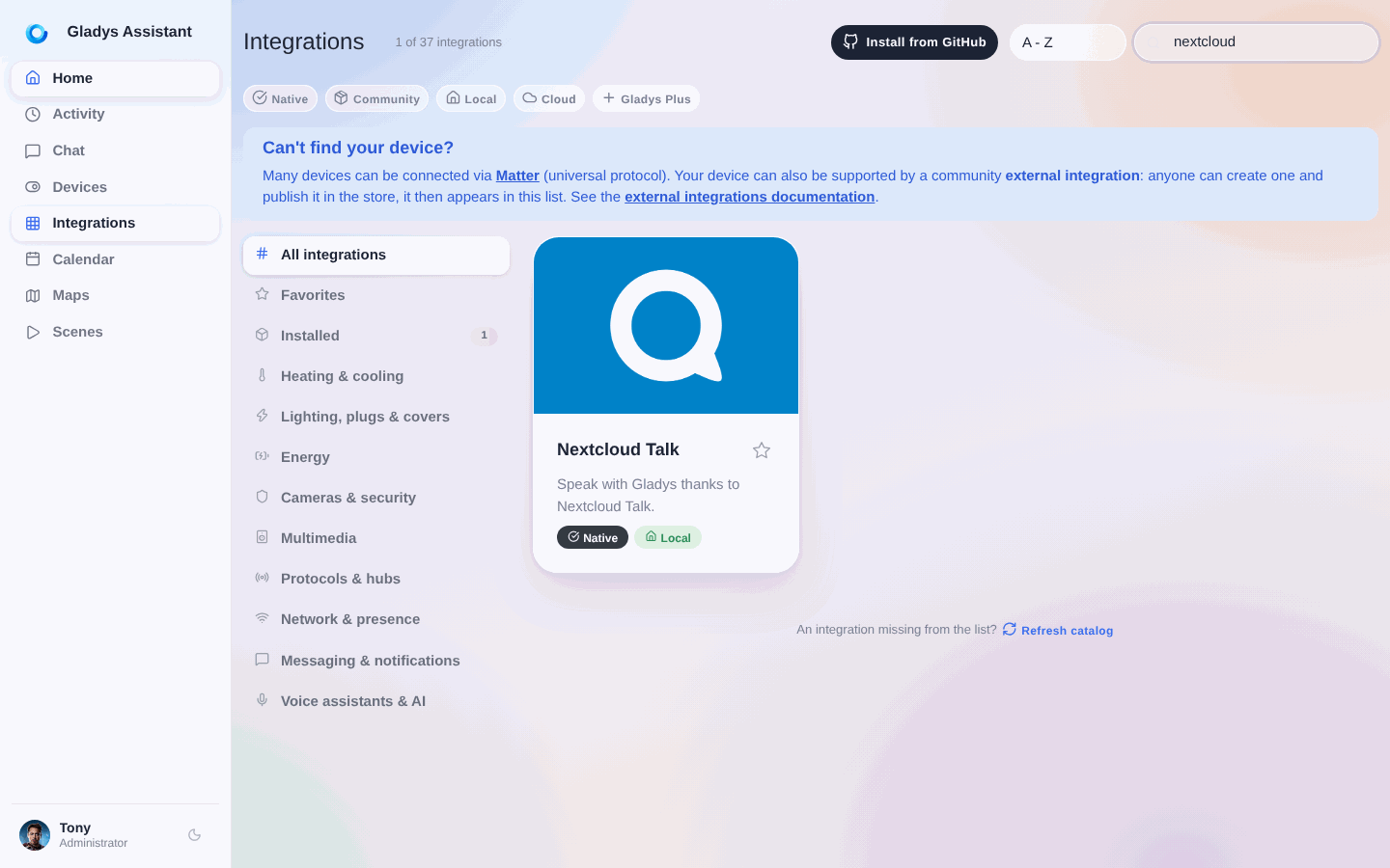

Go to "Integrations" -> "Nextcloud Talk".
Integration Nextcloud Talk

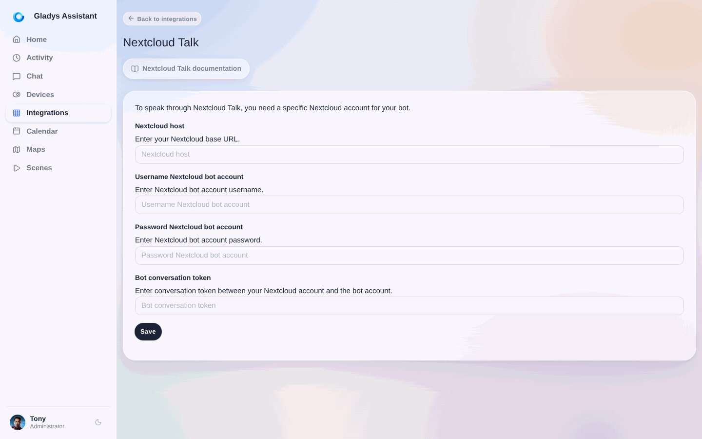

  1. Enter your Nextcloud instance base url
  2. Enter the username of your bot's Nextcloud account
  3. Paste here previously generated password
  4. Paste conversation token
Click on "Save".
Enter bot configuration Gladys Assistant
