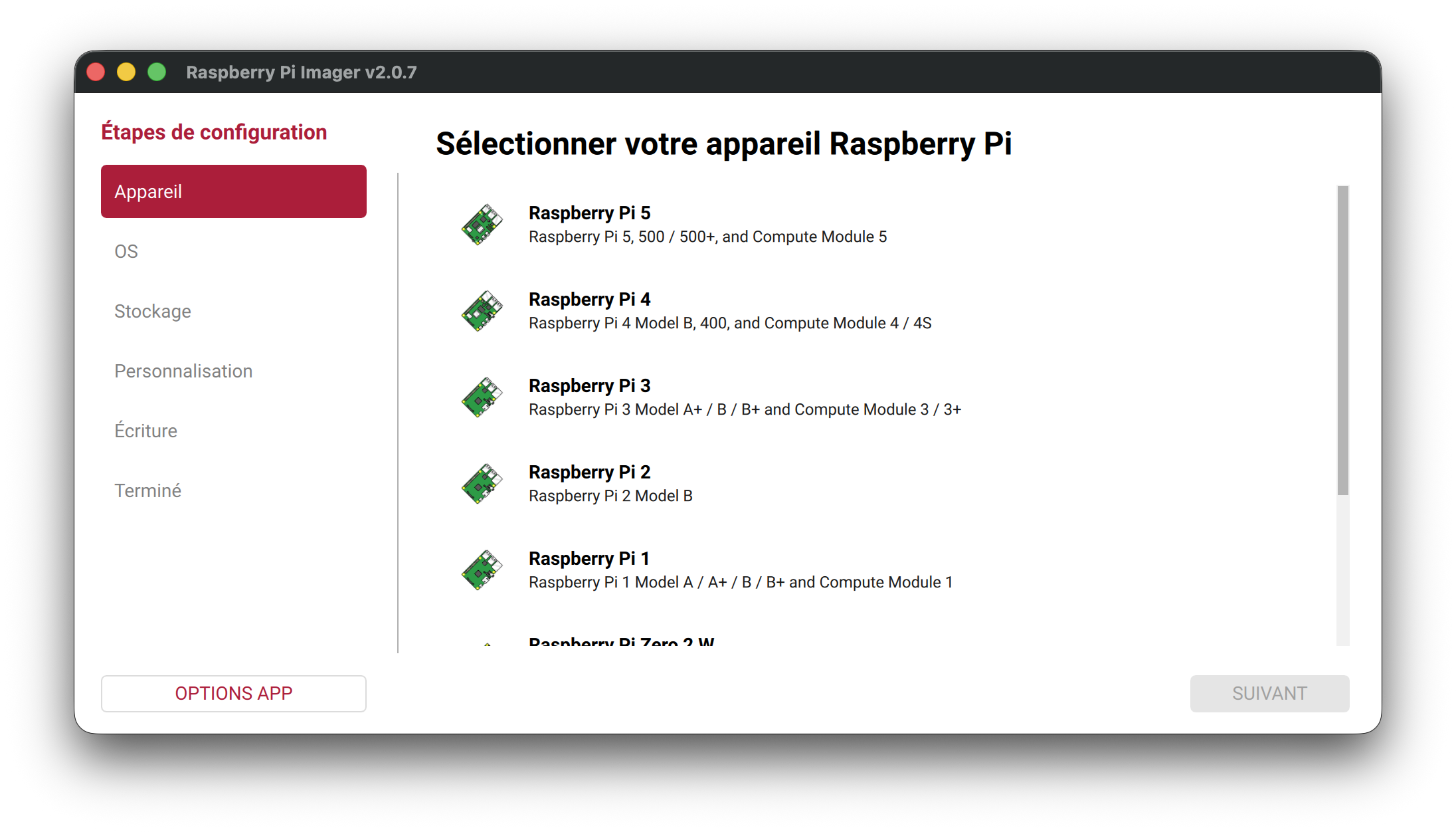

Step 2: Select Your Raspberry Pi​
Open Raspberry Pi Imager and click Choose Device (or NEXT if you're in the new step-by-step wizard).
Select your Raspberry Pi model from the list:

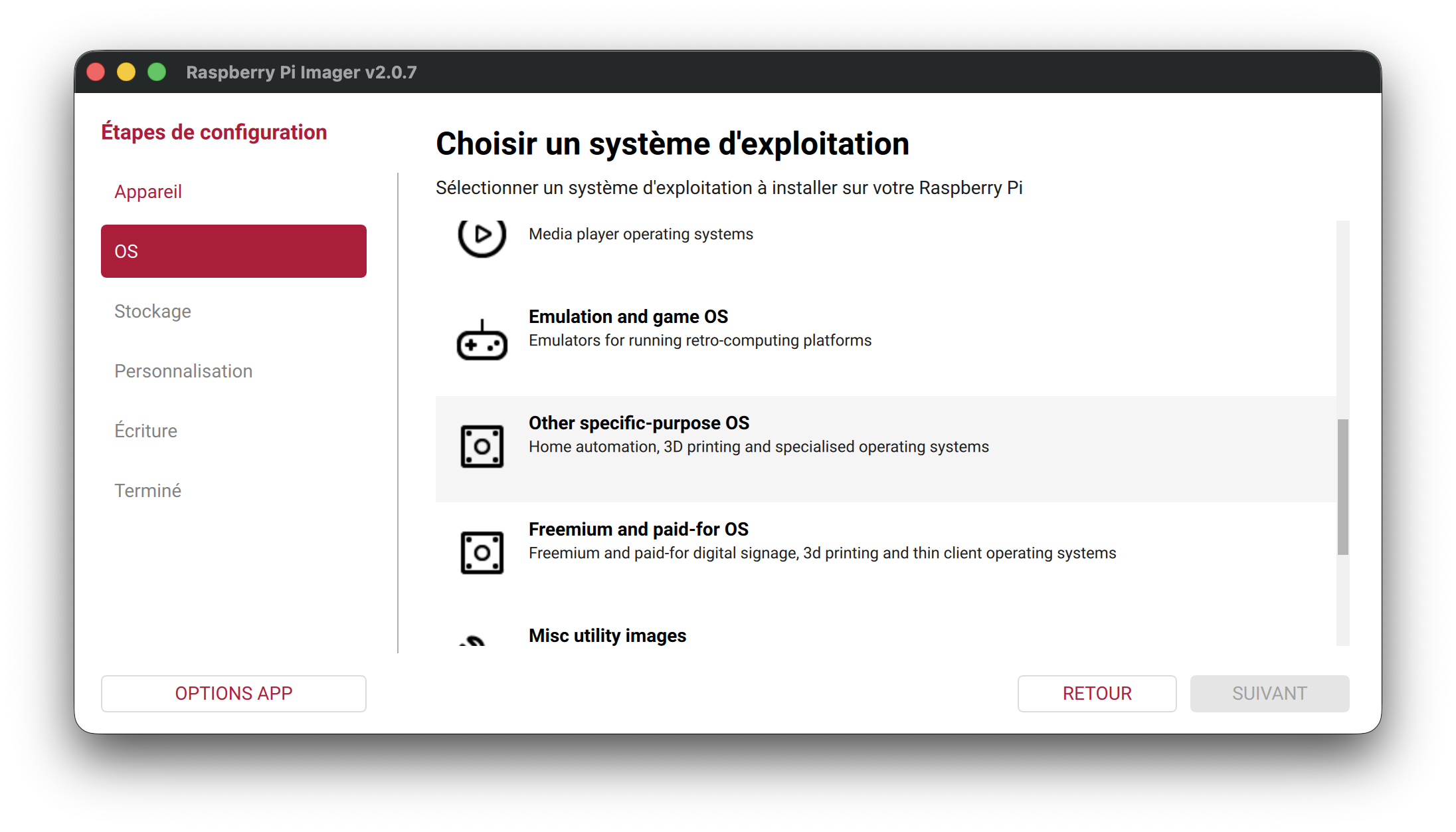

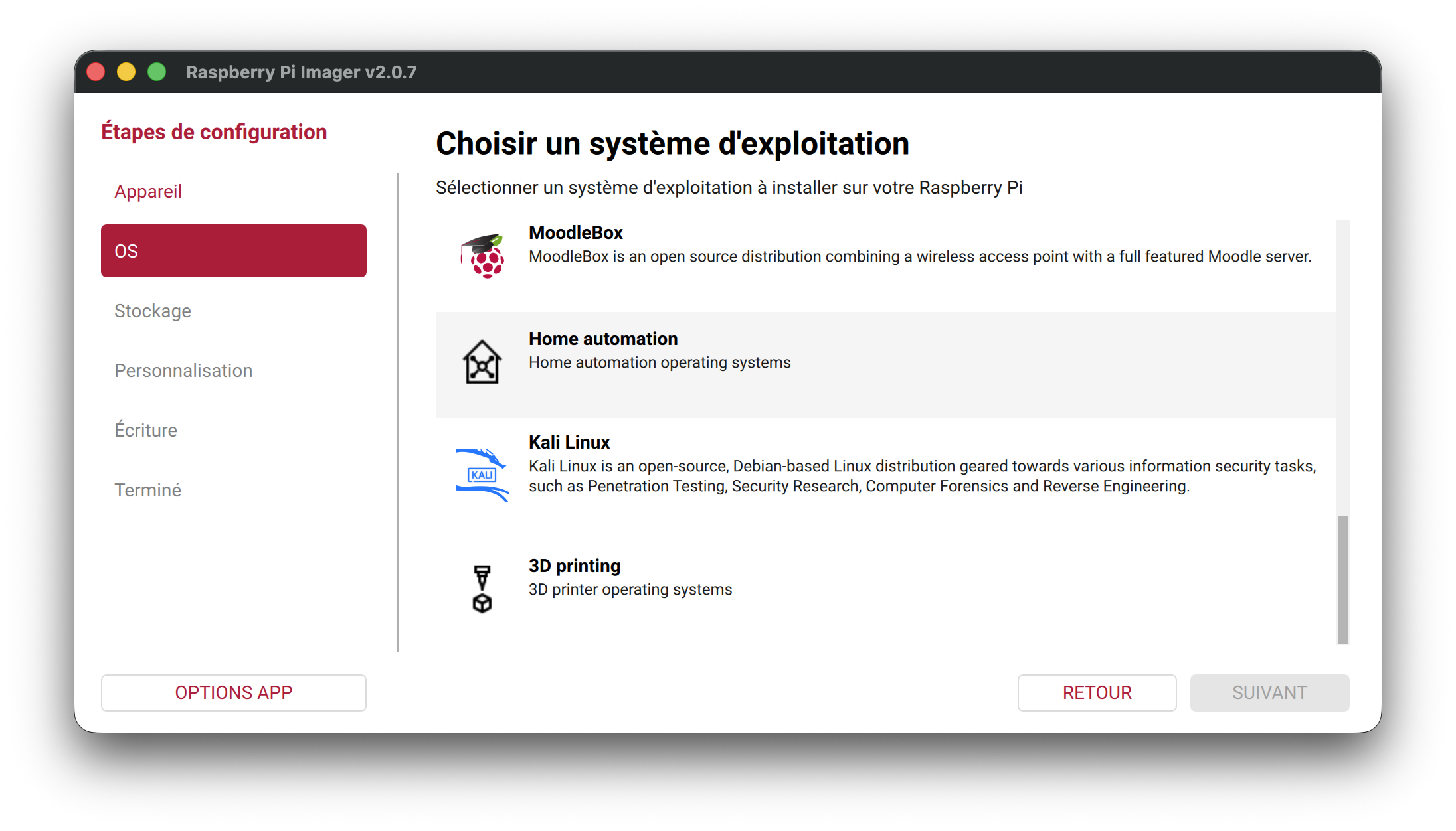

Click Choose OS, then navigate through the following categories:
  1. Other specific-purpose OS
  2. Home automation
  3. Gladys Assistant
Choose "Other specific-purpose OS" category

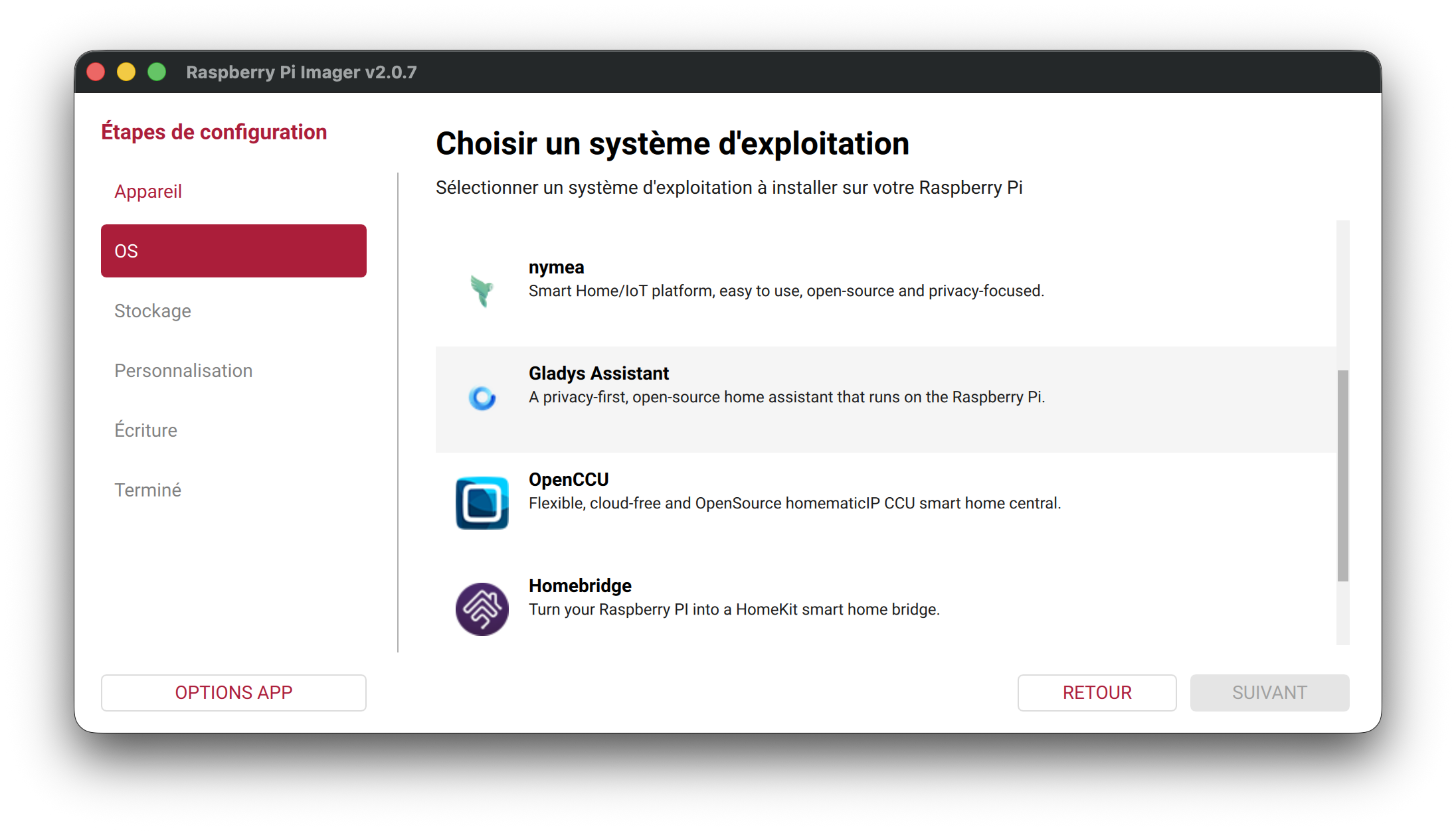

Choose "Home automation" category
Select Gladys Assistant

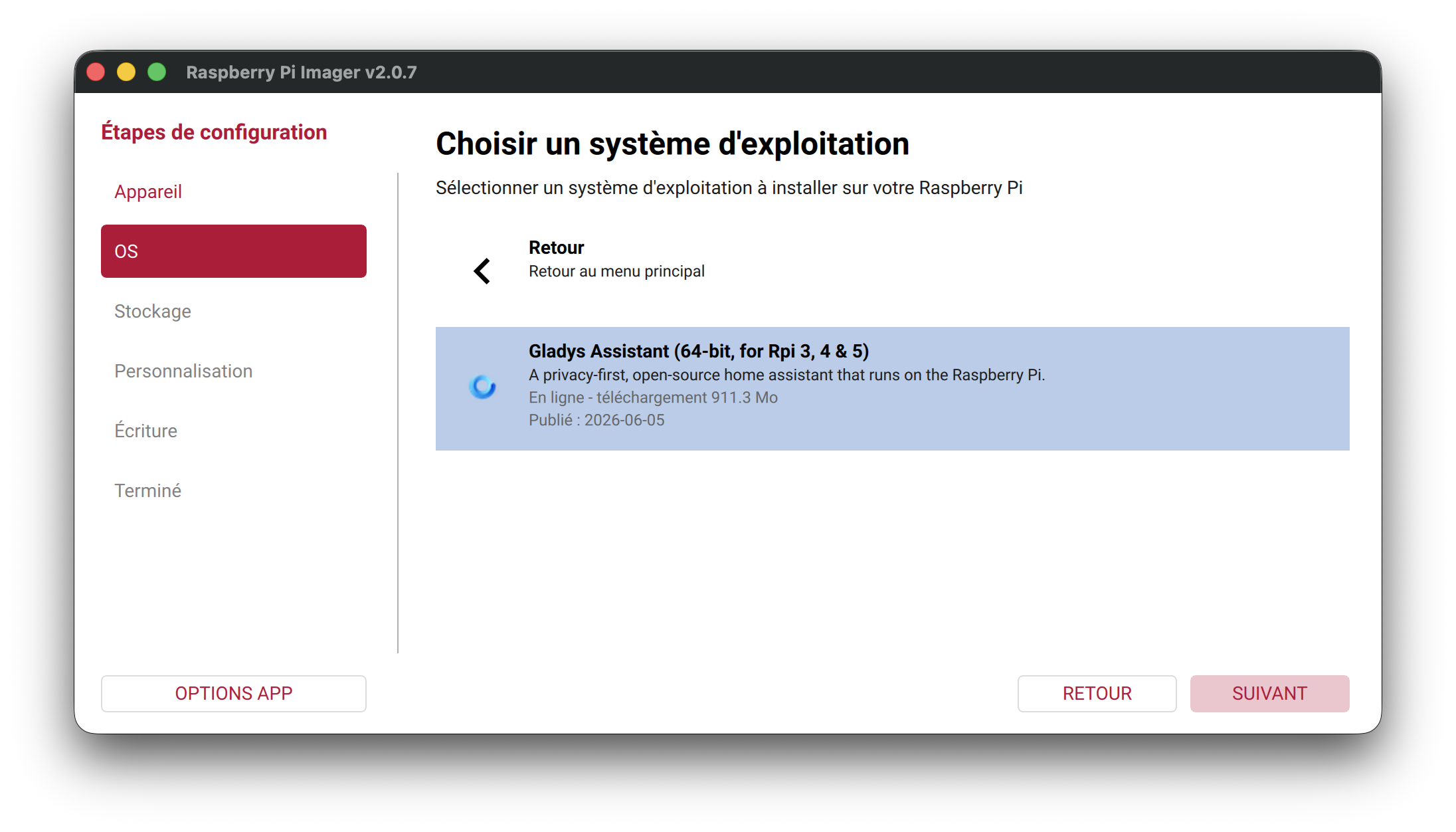

Then select the Gladys Assistant (64-bit, for Rpi 3, 4 & 5) image:
Gladys Assistant 64-bit image
tip
The image is about 900 MB to download. Raspberry Pi Imager handles everything: download, verification, and writing to your storage device.

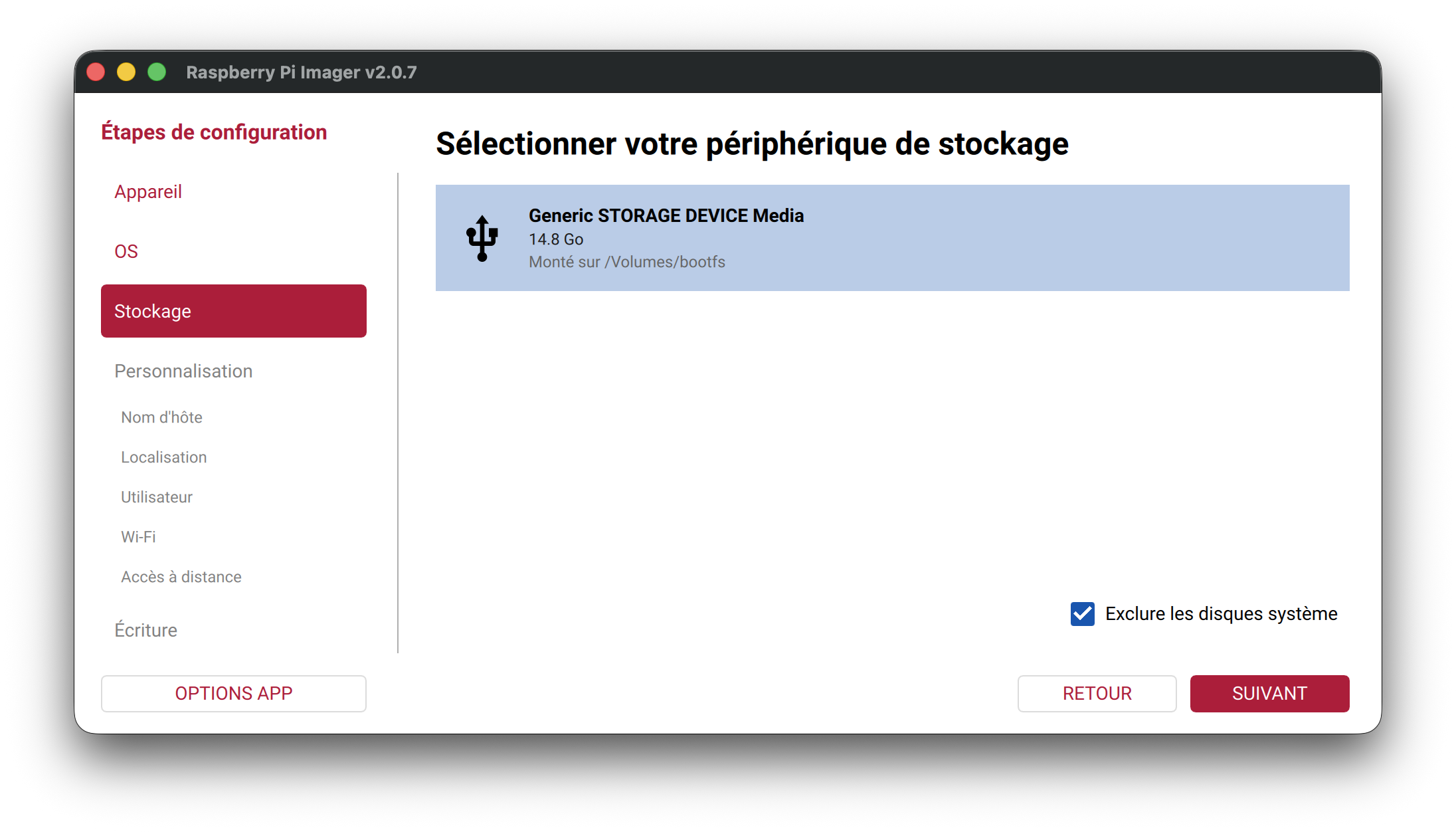

Step 4: Choose Storage​
Insert your micro-SD card or plug in your USB SSD, then click Choose Storage and select the corresponding device:
Select storage device
warning
Make sure you select the correct device: all data on this drive will be erased.

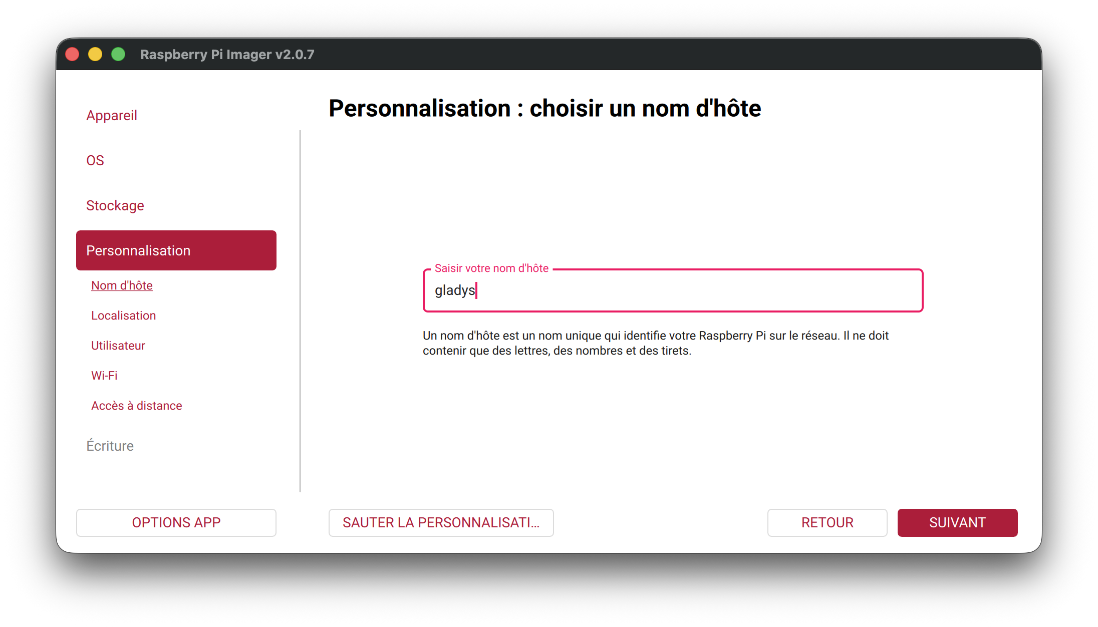

Hostname​
Choose a network name for your Raspberry Pi. For example gladys, you'll then be able to access it at http://gladys.local:
Configure hostname

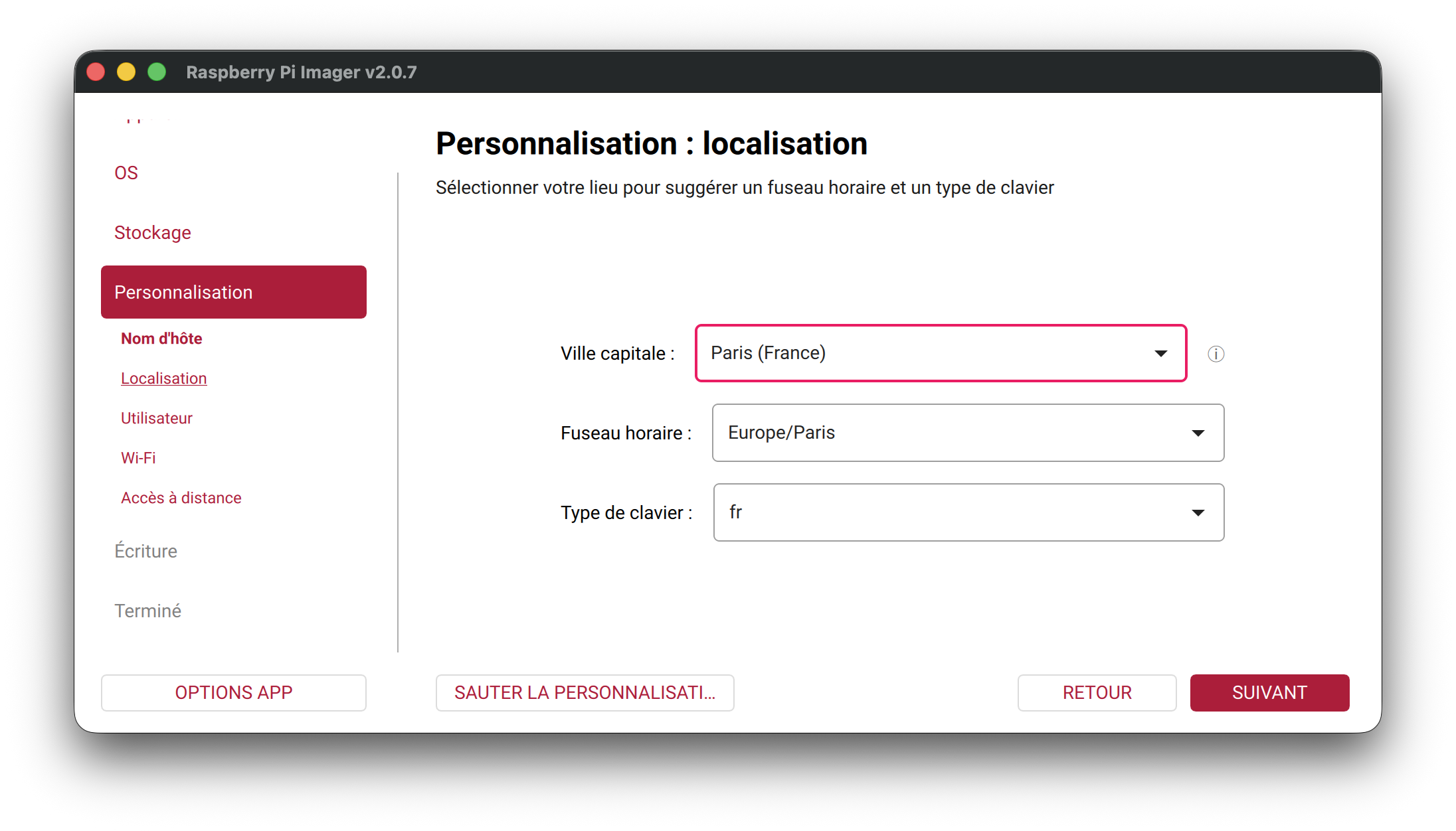

Localization​
Select your city, time zone, and keyboard layout:
Configure localization

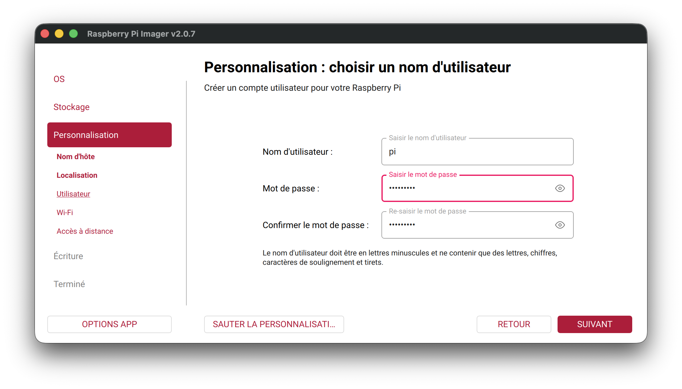

User Account​
Create a username and password. This account will be used for SSH access and system login:
Configure user account

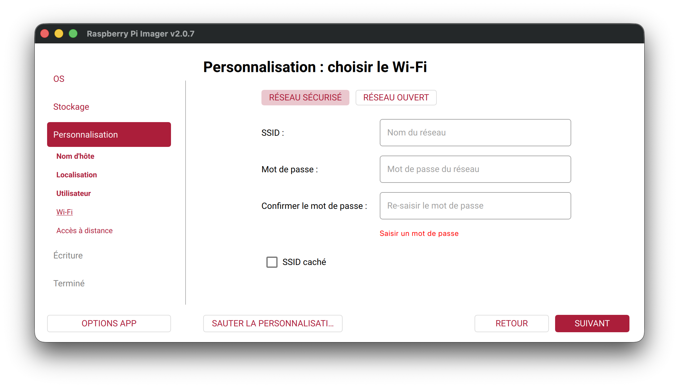

Wi-Fi (Optional)​
If you're not using an Ethernet cable, enter your Wi-Fi network name and password:
Configure Wi-Fi

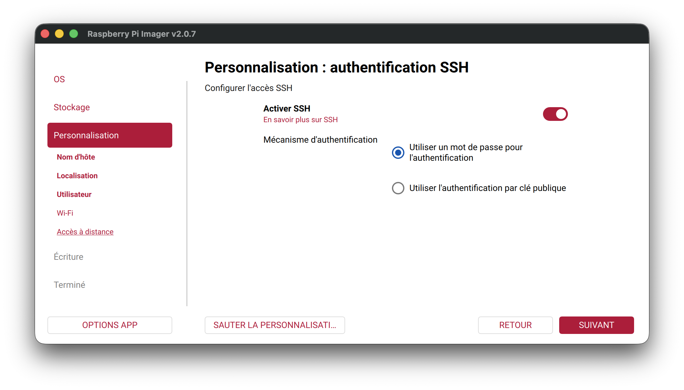

Enable SSH so you can connect to your Raspberry Pi remotely. Password authentication is the simplest way to get started:
Enable SSH

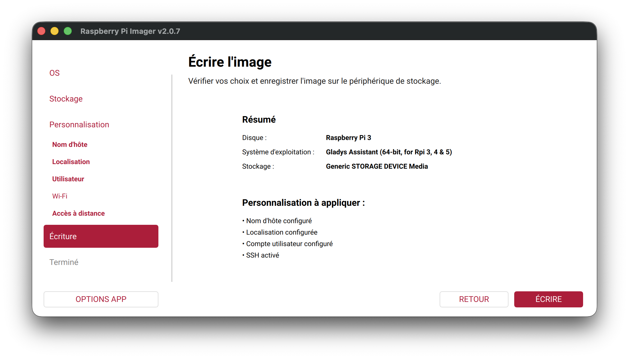

Step 6: Write the Image​
Review the summary of your configuration, then click WRITE:
Summary before writing

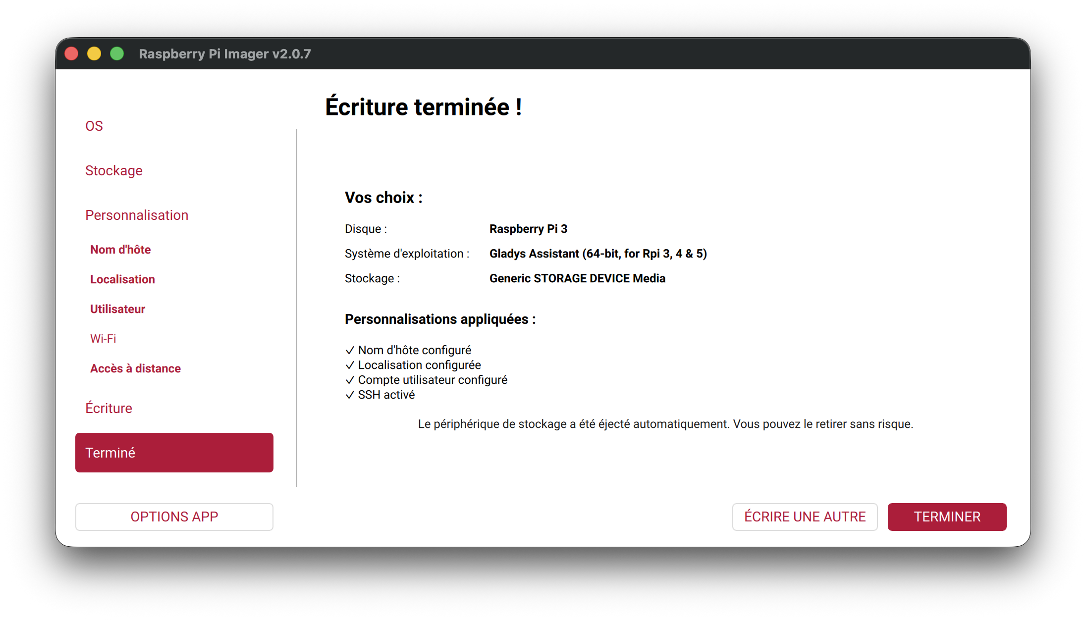

Writing can take several minutes depending on your storage speed. Once complete, Raspberry Pi Imager automatically ejects the device:
Writing complete

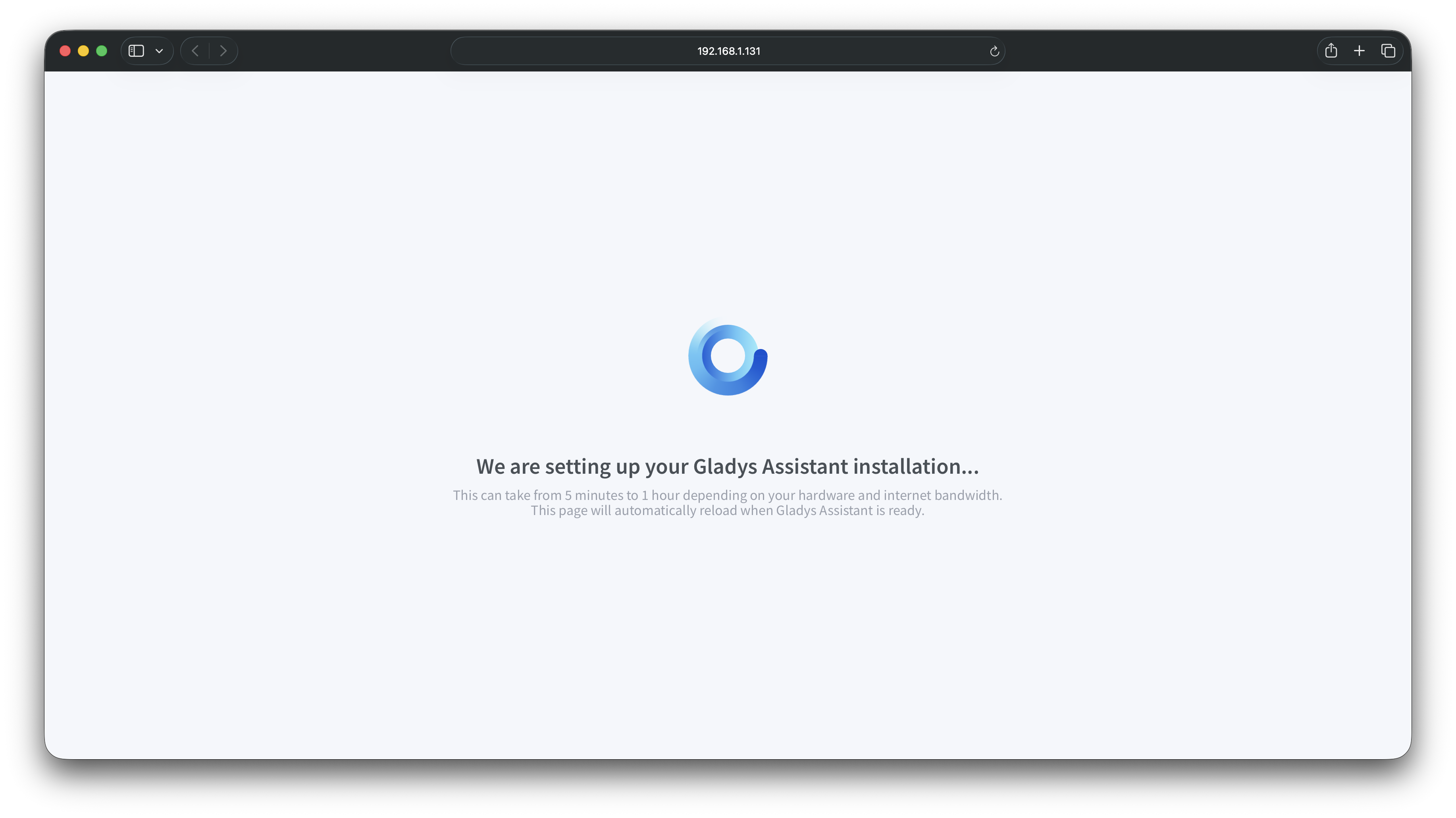

On first boot, Gladys runs its initial setup. This can take between 5 minutes and 1 hour depending on your hardware and internet connection:
Gladys initial setup
The page will reload automatically when Gladys is ready. You can then create your account and start setting up your smart home!
