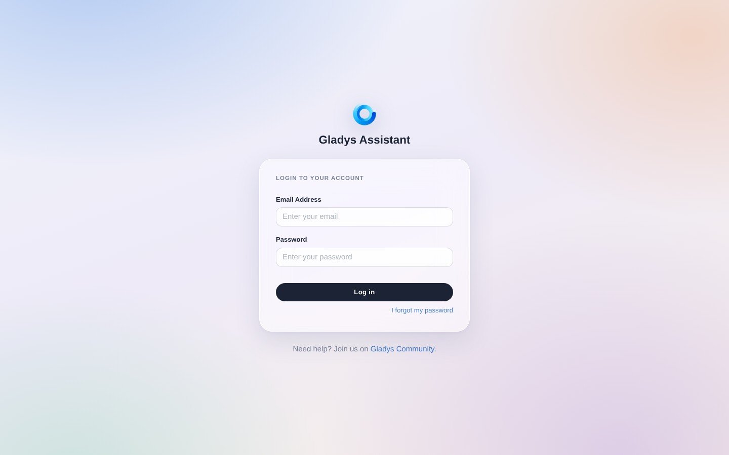

Accessing Gladys
You can access Gladys at http://gladysassistant.local, the name Gladys announces on your local network over mDNS. If your network blocks mDNS, type the IP of your VM in your browser instead.
Accessing Gladys
