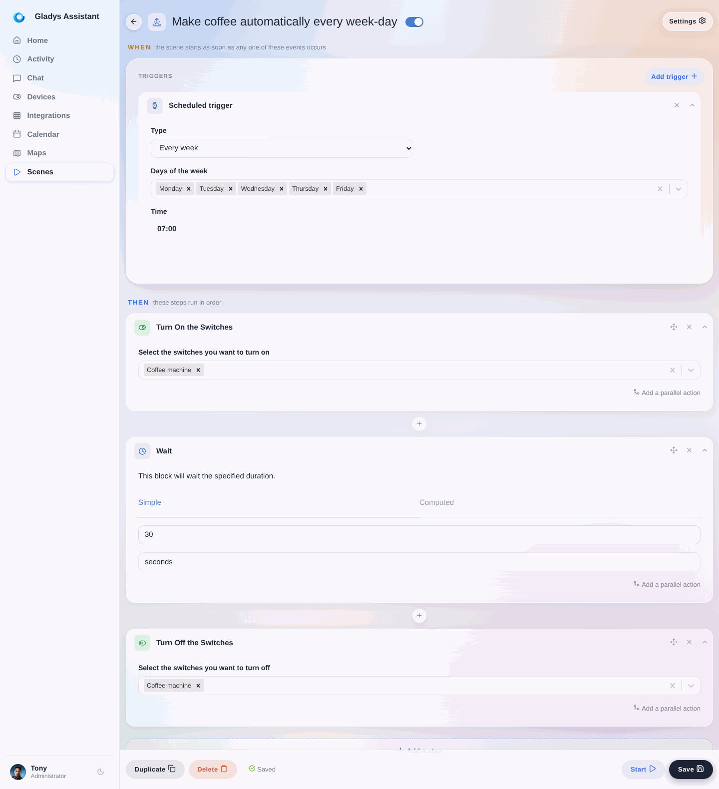

We can therefore imagine the following scene:
Trigger: "Monday to Friday at 7 a.m."
Actions:
- Switch on the "coffee machine" socket
- Wait 30 seconds (for the coffee to be prepared)
- Switch off the "coffee machine" socket
In Gladys, the scene will look like this:
Make coffee automatically every morning of the week with Gladys
As you can see, first there is a trigger that goes off every day of the week except weekends (Monday to Friday).
Then the scene turns on the outlet, waits 30 seconds, then turns off the outlet.
Super simple, right?
