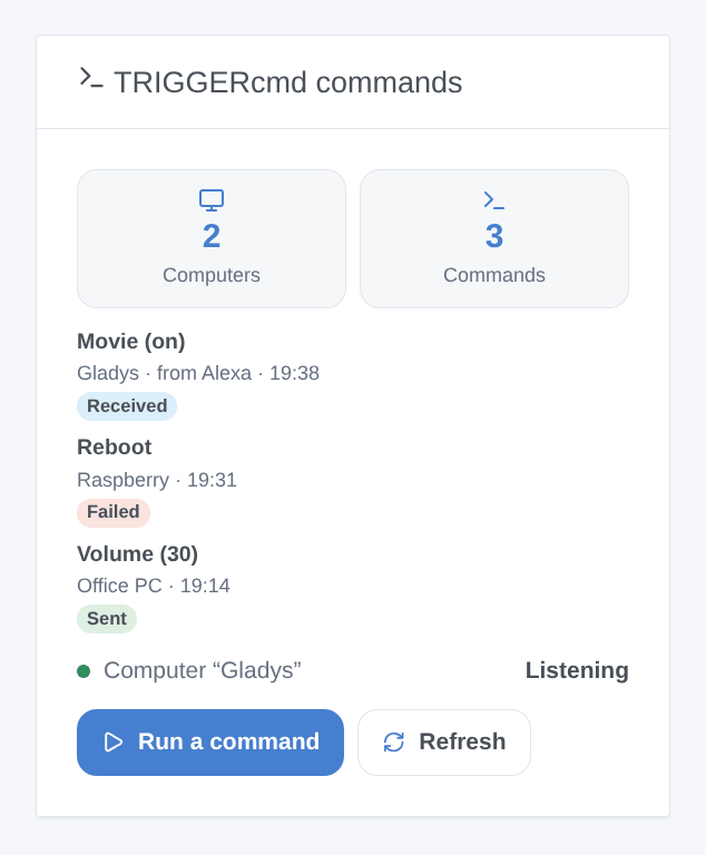

Dashboard widget​
The widget: the computers and commands, the last runs, the Gladys computer and the Run a command button (generated illustration, not a screenshot)
The TRIGGERcmd commands widget shows one computer (setting) or all of them: the number of computers and commands, the state of the Gladys computer, the last runs (sent, failed, or received with who sent them) and a Run a command button. Its form lists the commands (40 at most) and has a Parameters field, for the commands that allow parameters. Refresh reads the commands again.
