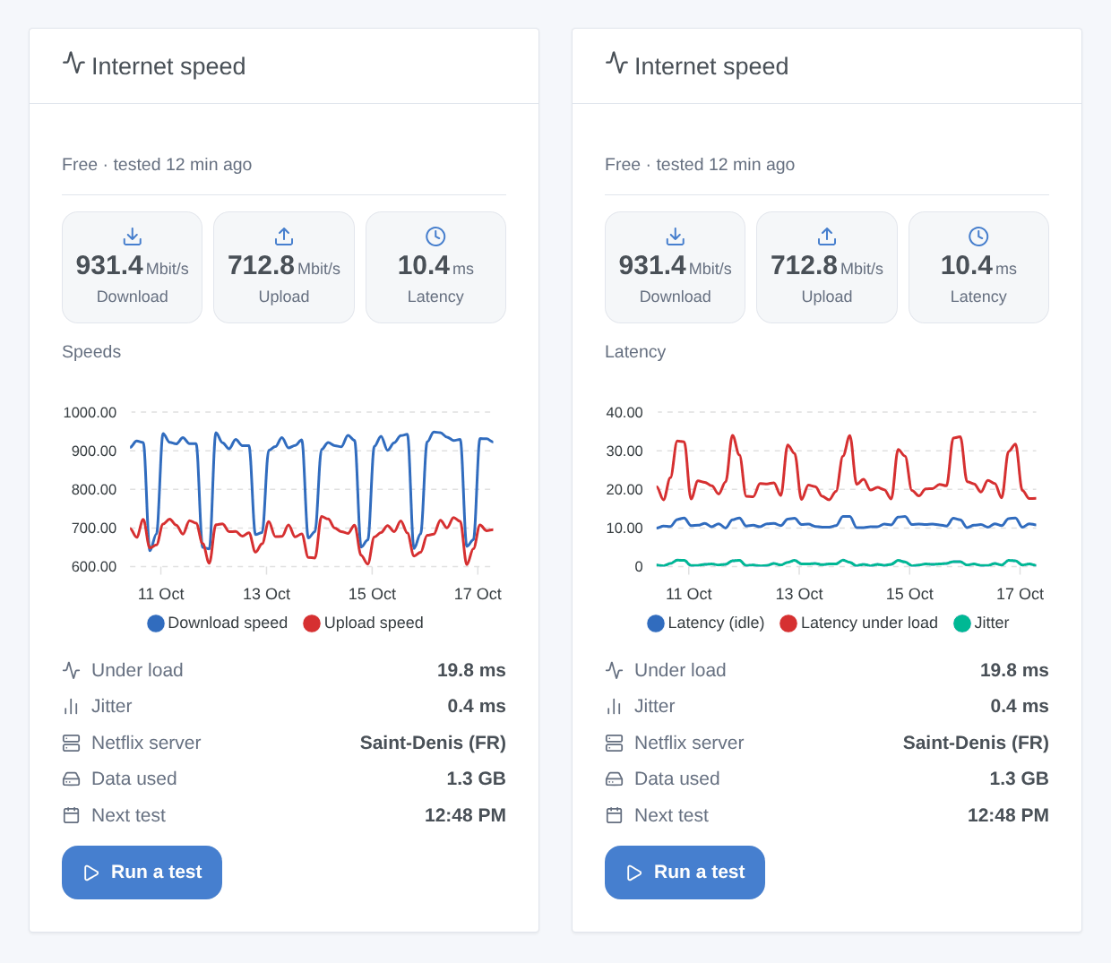

The Internet speed widget twice: with the speed history, and with the latency history (generated illustration, not a screenshot)
The Internet speed widget shows the provider and the age of the last test, the download, upload and latency tiles, a chart, the latency under load, the jitter, the Netflix server, the data used, the time of the next test, and a Run a test button (the result appears at the end, without waiting in front of a spinner). Settings: the chart (download and upload, latency and jitter, or none) and its period (24 hours to 3 months). The chart reads the history of the device: add the device first.
