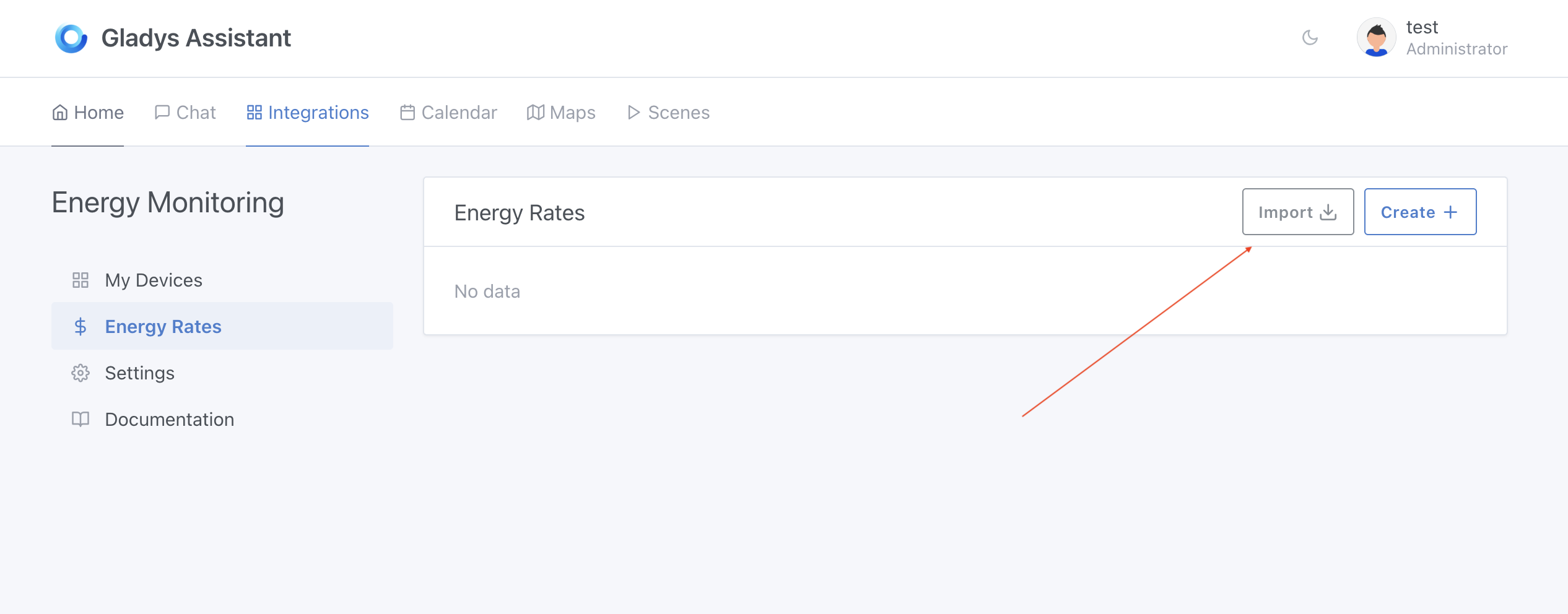

Import a contract
To configure your contract, go to the "Energy Monitoring" integration, in the "Energy rates" tab, then click "Import":

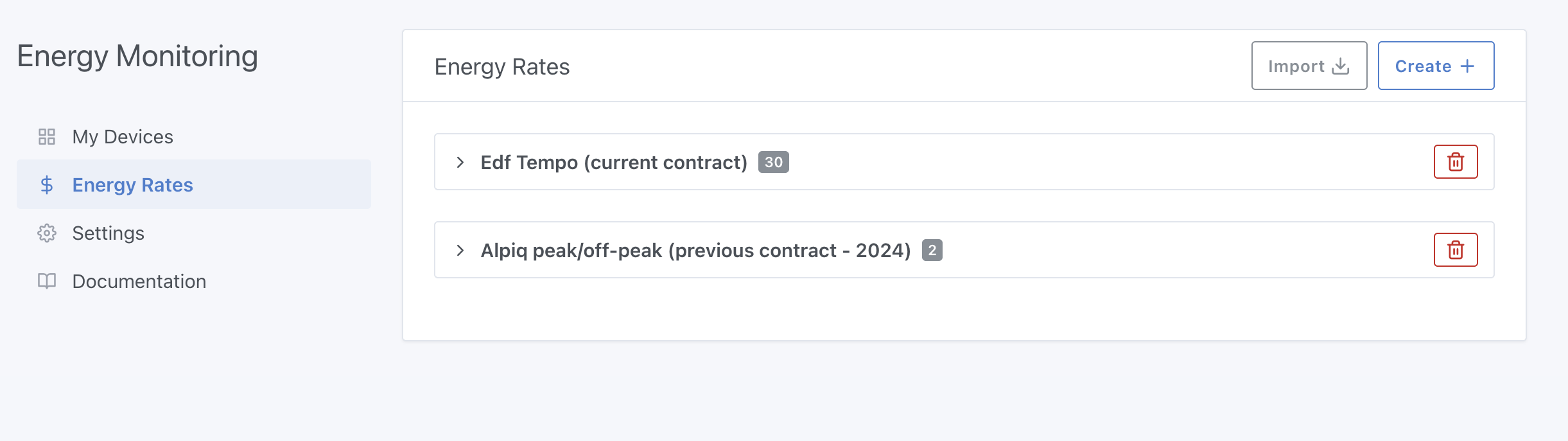

Manually create a contract
If your contract is not in the list, click "Create".
You'll need to create one price per period and per price type. If you're on a peak/off-peak hours contract, you'll need to create 2 prices for each period.
Example:
If in 2024 your energy rate was €0.15/kWh during peak hours and €0.10/kWh during off-peak hours, and in 2025 prices drop by €0.05/kWh, you'll need to create 4 prices:
  • 2024 peak hours
  • 2024 off-peak hours
  • 2025 peak hours
  • 2025 off-peak hours

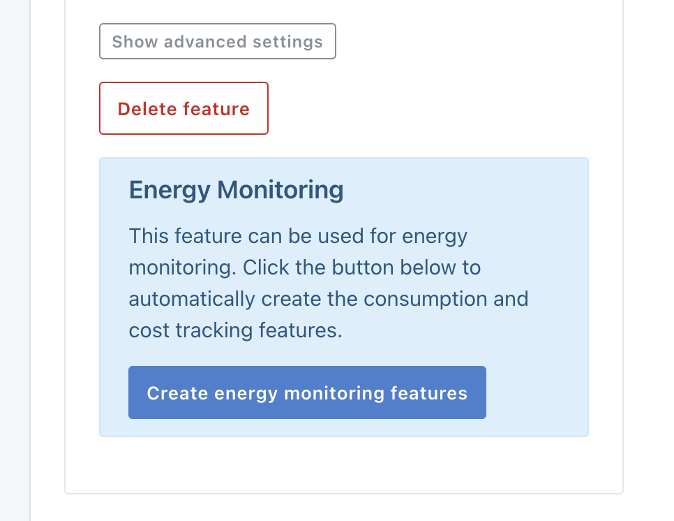

Step 4: Update your MQTT devices
In the MQTT integration, if you have devices with "Index" features, you will see a new button on "Index" features to enable the energy monitoring feature:
Update MQTT device
This will add the features necessary for energy monitoring.

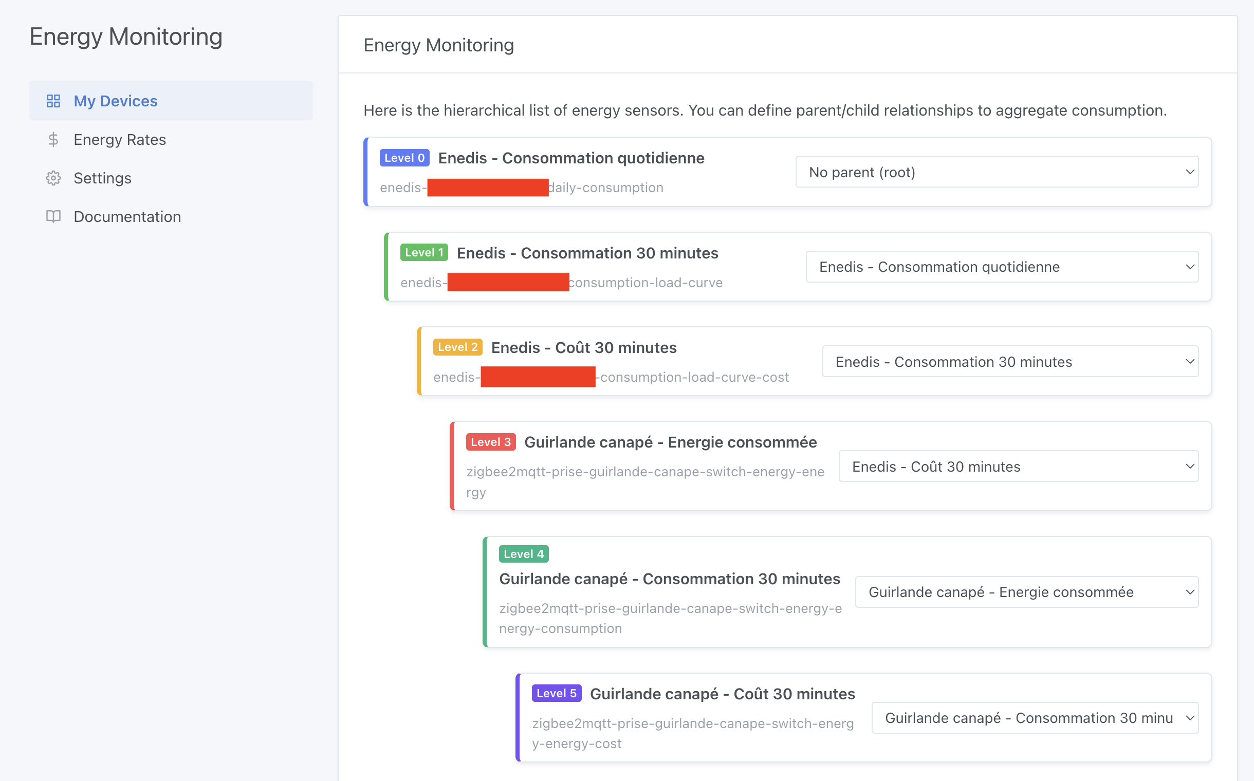

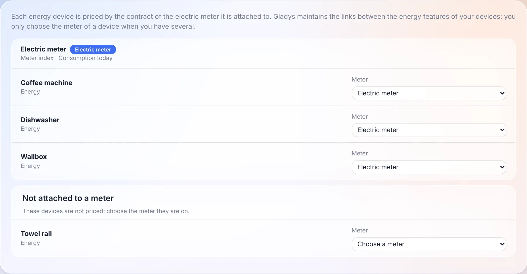

Step 5: Verify your electrical network hierarchy
Go to the "Energy Monitoring" integration, and on the first tab, you should see your electrical network hierarchy.
Energy monitoring hierarchy
Verify that each device is properly associated with its parent.
In Gladys logic, a device's "parent" corresponds to what the device is plugged into.
An example hierarchy:
- Electricity meter
- NOUS A1Z plug (Energy consumed)
- NOUS A1Z plug (30-minute consumption)
- NOUS A1Z plug (30-minute cost)
The hierarchy is very important for Gladys to correctly calculate your consumption cost.

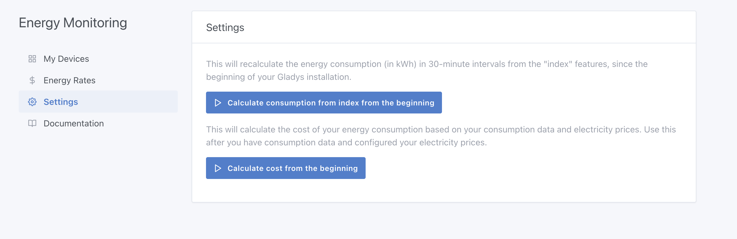

Step 6: Recalculate all historical consumption
If your devices have consumption history, you can launch a recalculation of historical 30-minute consumption and 30-minute costs from the "Settings" tab:
Recalculate historical consumption
First click on the first button to calculate consumption from indexes, then click on the second button to calculate 30-minute costs.

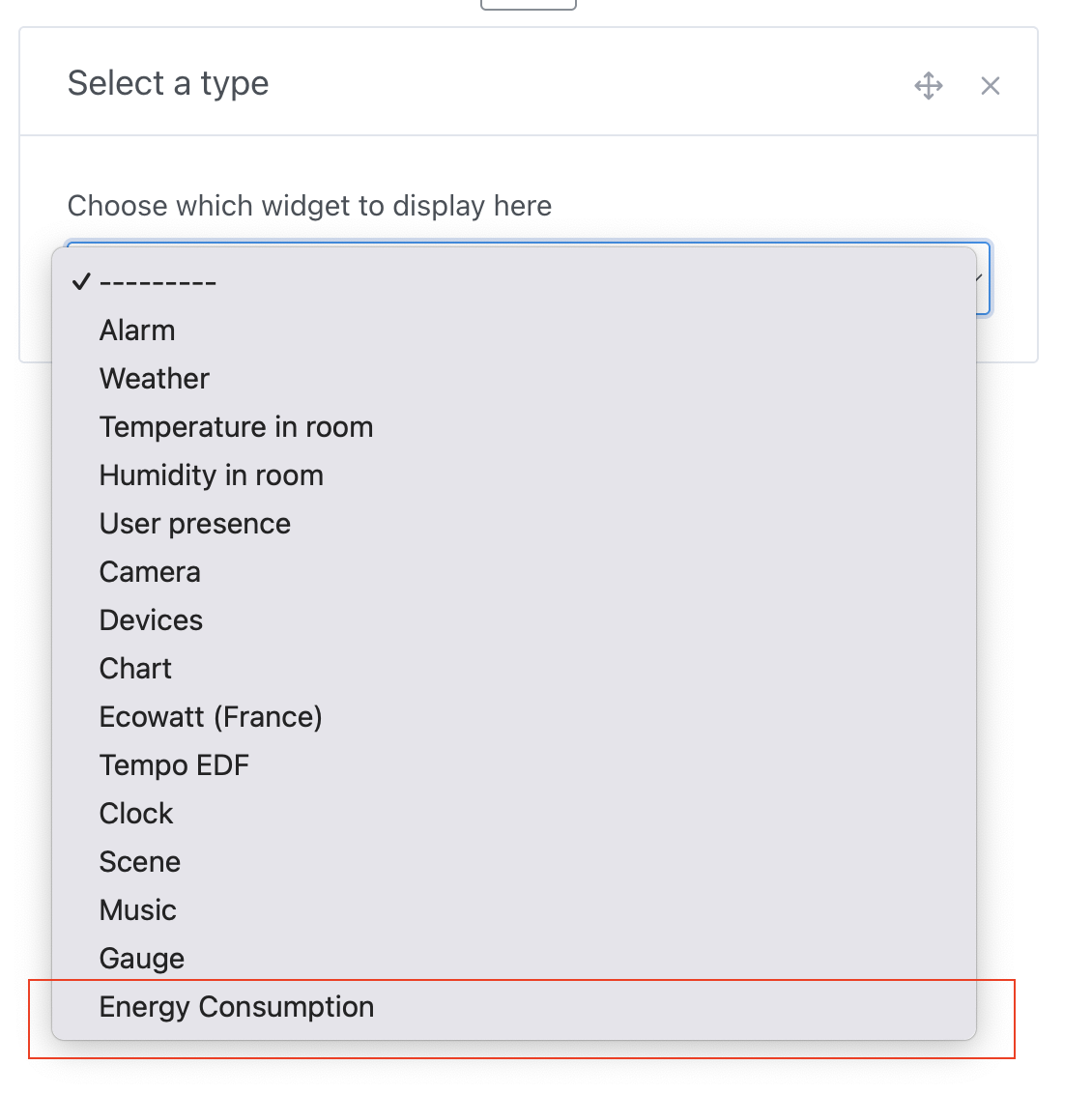

Step 7: Display your consumption on the dashboard
On your dashboard, you can now add a new "Energy Consumption" widget:
Dashboard energy widget
