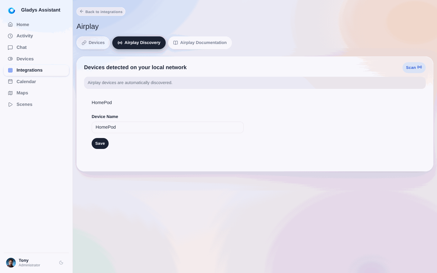

Add a speaker in Gladys
After adding your speakers in the Airplay application, go back to Gladys:
  1. go to the Integration -> Airplay page in Gladys
  2. select the Airplay Discovery menu
    Airplay device discovery
  3. click on the Scan button at top right (if the device is not already in the list)
  4. finally, click on Save for the speakers you want to integrate into Gladys
  5. and you're done!

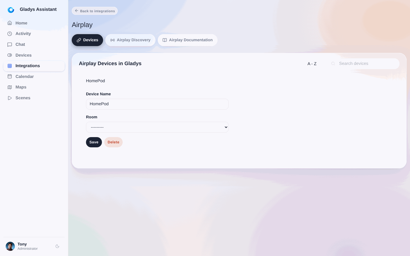

Rename / place a speaker in a room
If necessary, you can go to the Devices menu to modify / complete the configuration of your speakers by adding them to a room or renaming them.
Airplay devices tab

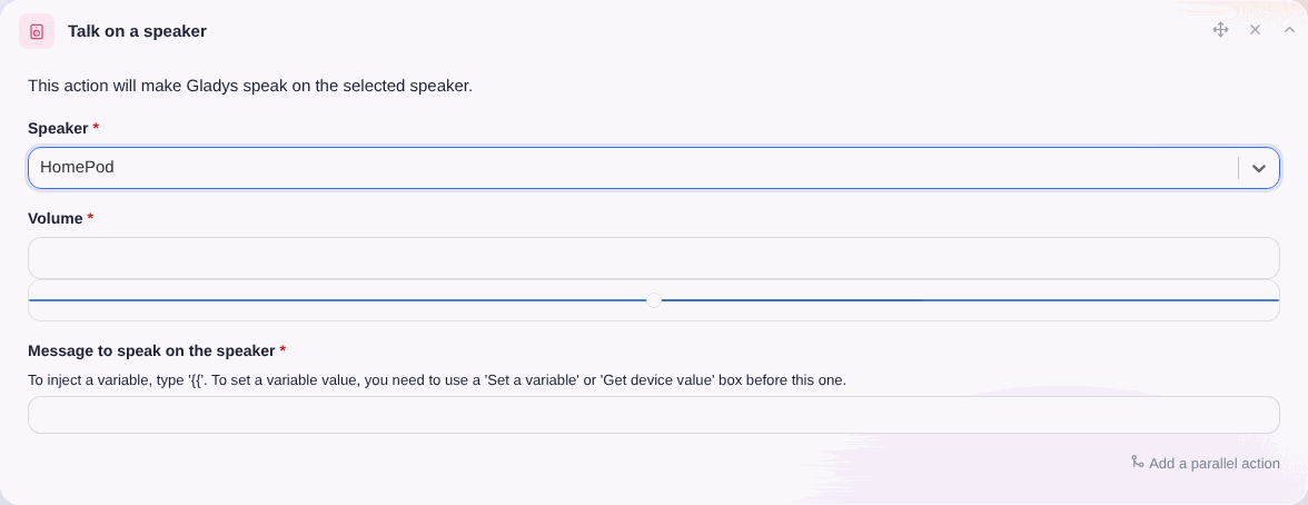

Let Gladys talks
In the scenes, you can now make Gladys speak throught your Airplay device.
Talking on an Airplay speaker
