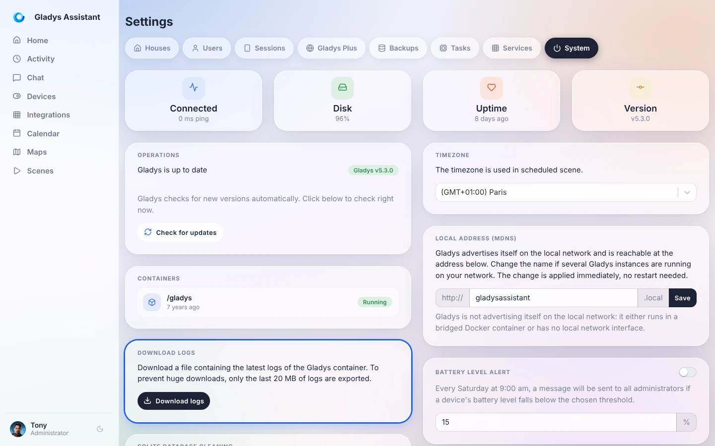

Open Gladys in your browser, click on your name at the bottom left of the menu, then on Settings.
Open Gladys settings from the user menu
Open the System tab, then in the Download logs card, click on Download logs.
The "Download logs" card in the System tab of Gladys settings

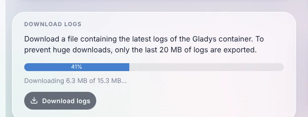

Gladys gathers the logs and downloads them in chunks: a progress bar shows how far along it is.
The download of the logs in progress
Once it is done, your browser saves a text file named like gladys-logs-2026-10-26-101203.log. You can open it with any text editor.
