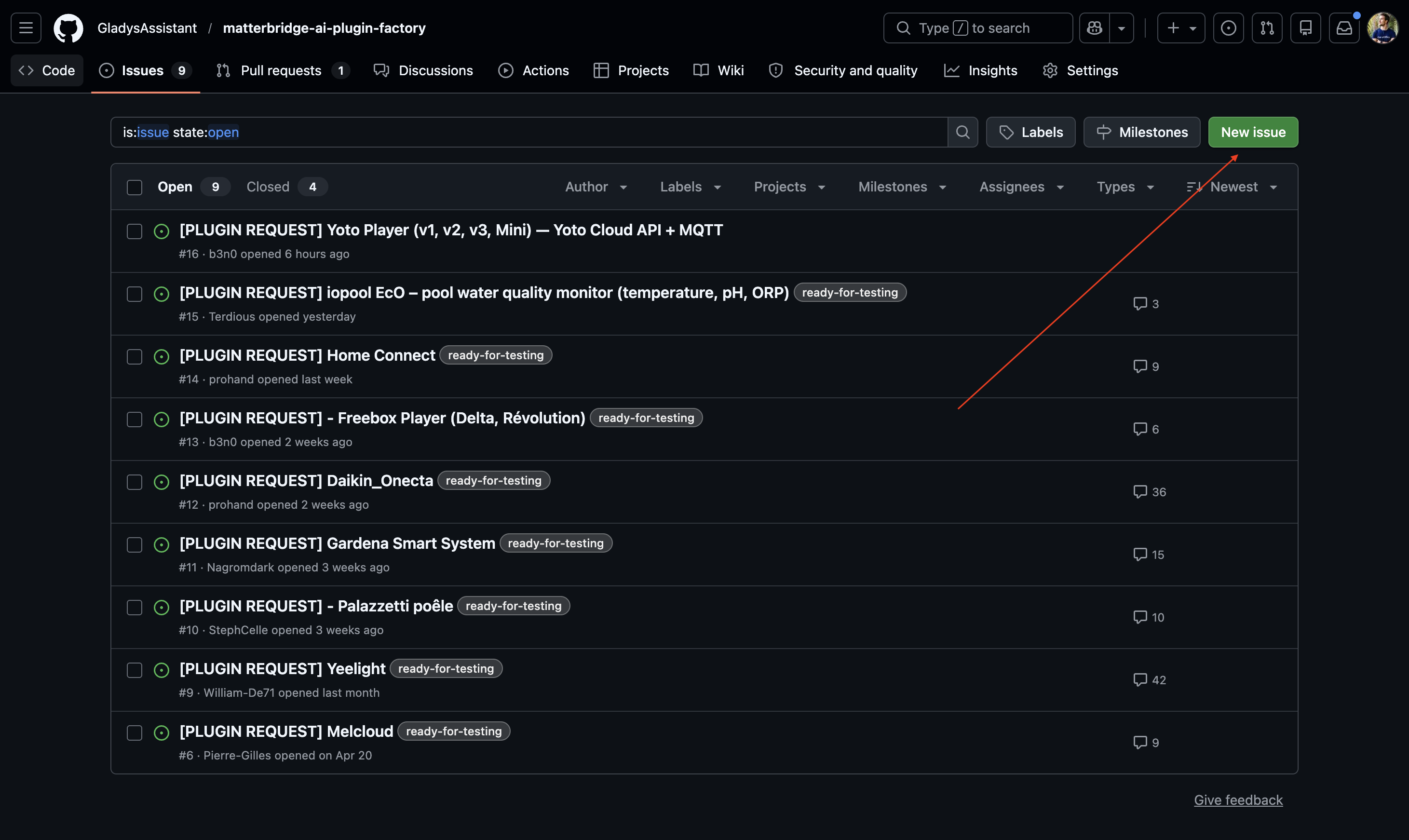

Head over to the factory repository: 👉 matterbridge-ai-plugin-factory/issues

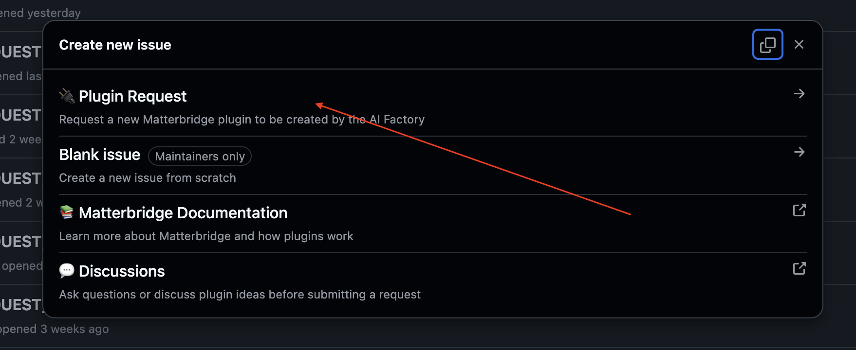

Click "New Issue":
Create a new issue
Then select the "Plugin Request" template:

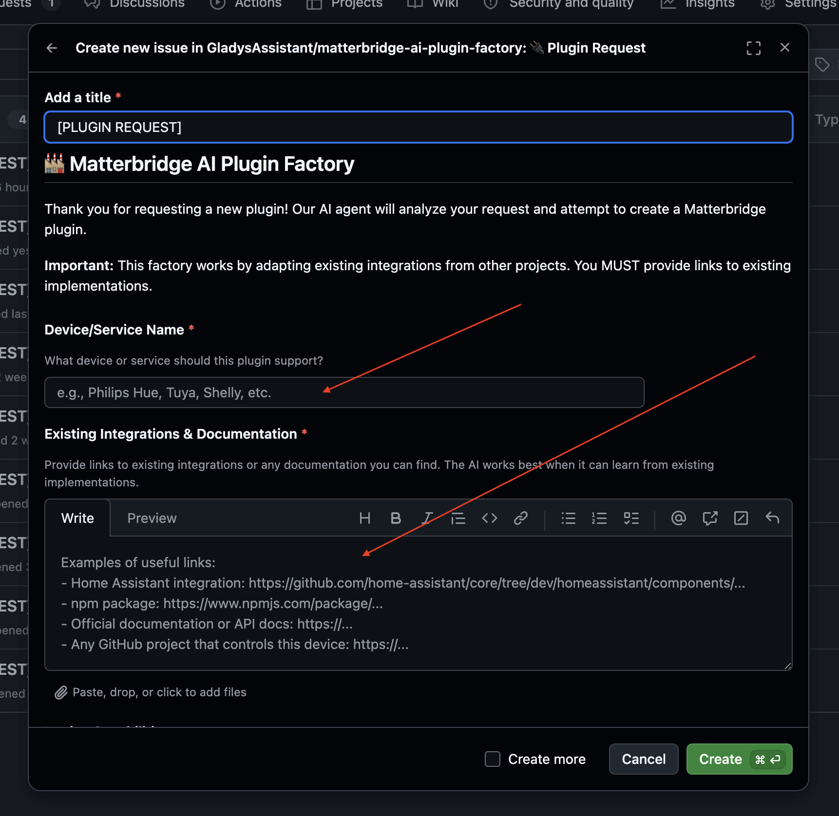

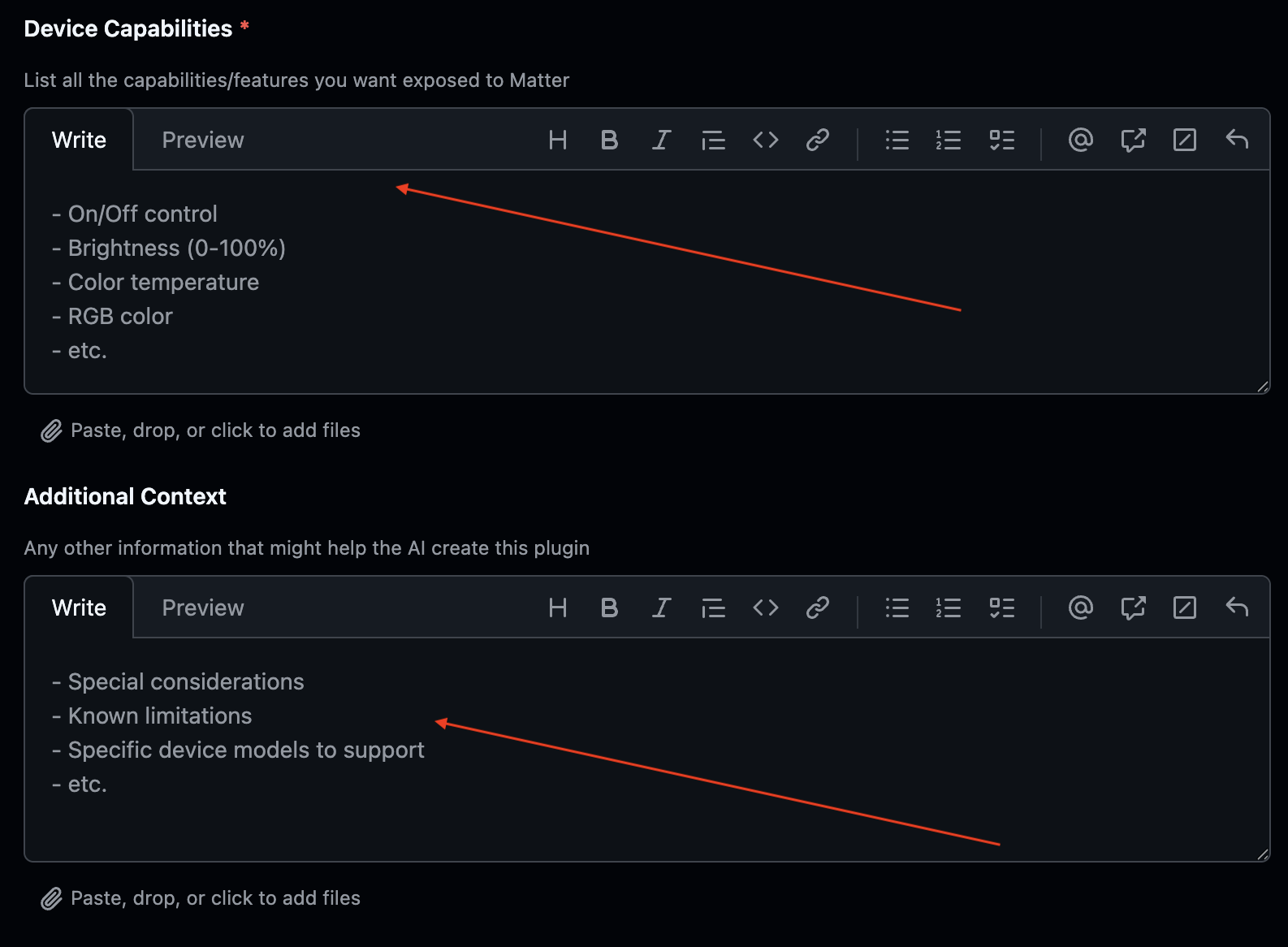

Fill in the form:
  • Title: the name of the plugin you want
  • Links: if you know of similar plugins on other projects (Home Assistant, Homebridge…), add the links. The more context you provide, the more relevant the result will be on the first try.
  • Features: describe what you want to control. Examples: temperature, on/off, humidity, brightness…
  • Additional context: optional, but useful if your device has any quirks.
Fill in the plugin request form
Plugin request details
Tip: if you don't know what to put in the links, say so in the description and ask the AI to search on its own. But the more precise you are, the better the result.

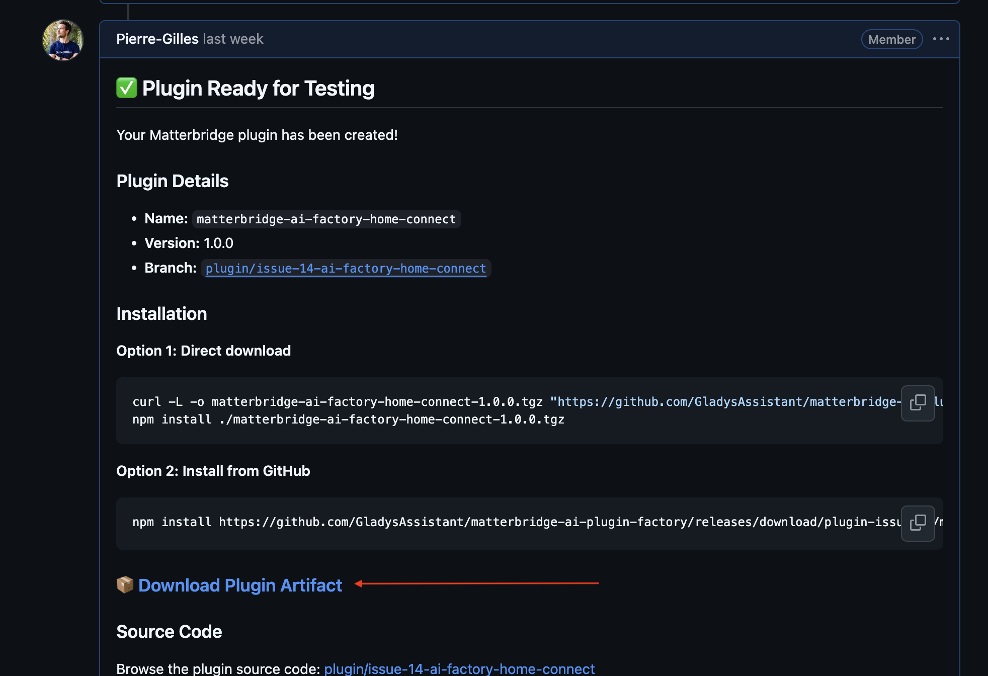

The factory runs every morning and processes one plugin per run. Once yours is developed, the AI replies directly on the ticket with a download link:
The AI replies with a download link

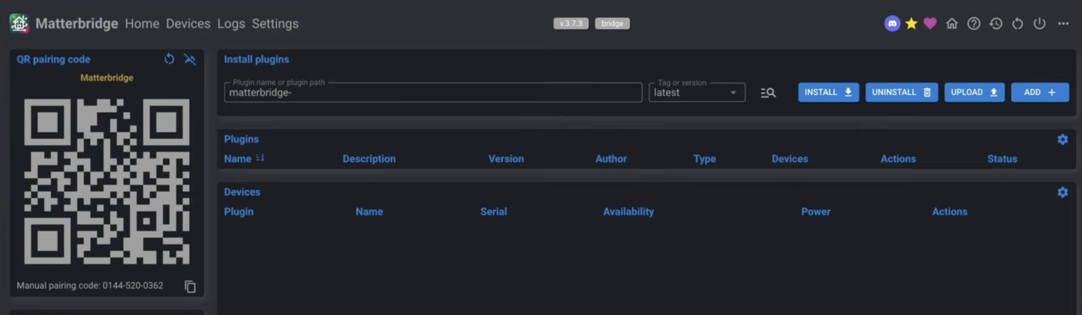

Download the file, then in Matterbridge click "Upload +":
Upload the plugin in Matterbridge
Then enter the plugin name in the "Plugin Name" field and click "Add +":
Add the plugin
The plugin is installed, you can test it!

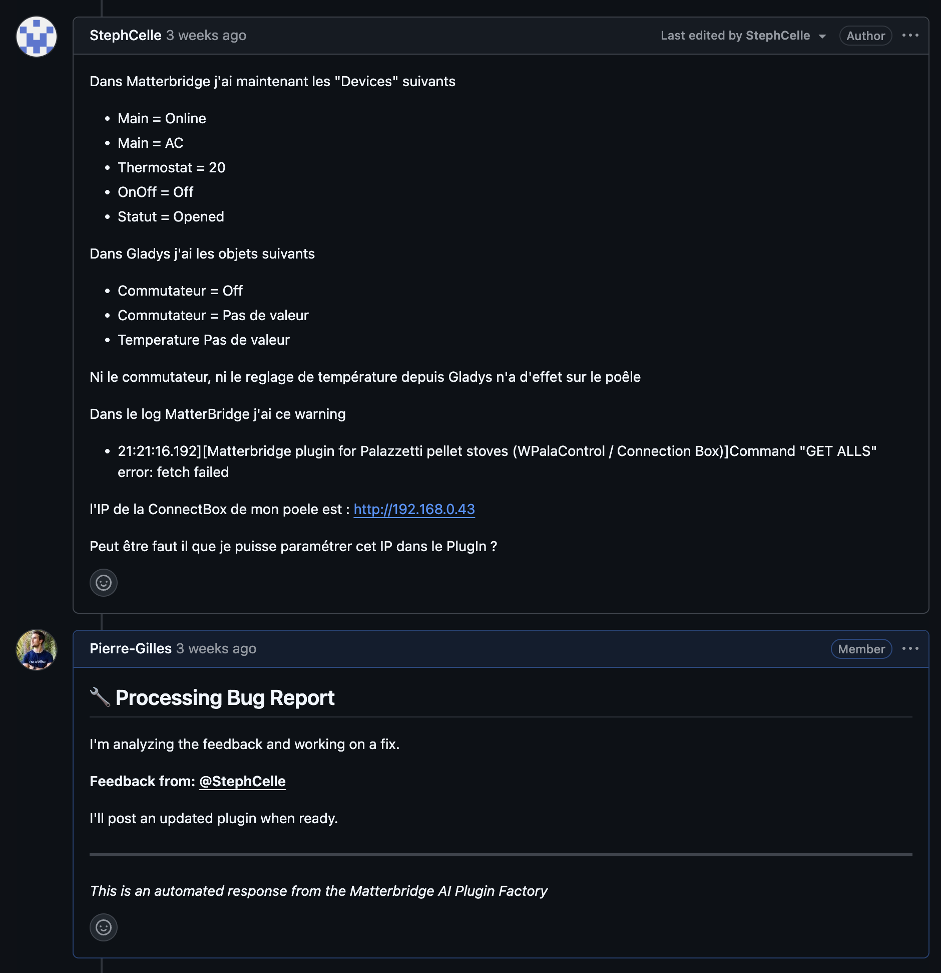

If the plugin doesn't work as expected, leave a comment on the GitHub ticket. The AI will read your feedback and fix the plugin on the next run:
Leave feedback on the ticket
