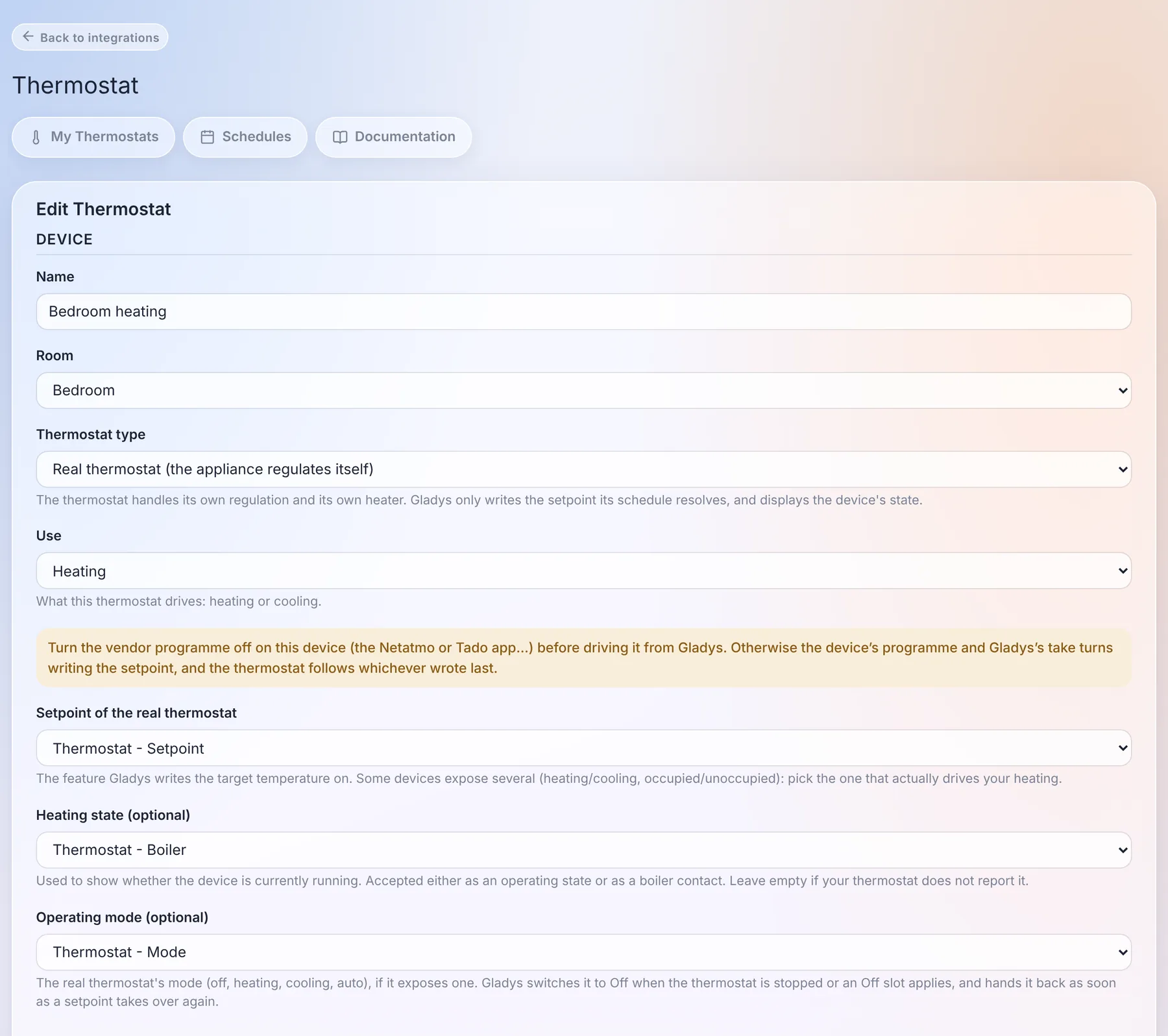

The form of a real thermostat: Gladys drives the setpoint, the heating state and the mode of the device
A detail I'm quite happy with: if someone turns the dial of the real thermostat, or changes the temperature from the vendor app, Gladys sees it and treats it as a manual change. It doesn't overwrite it a minute later, which is the classic bug of thermostats driven by two masters.

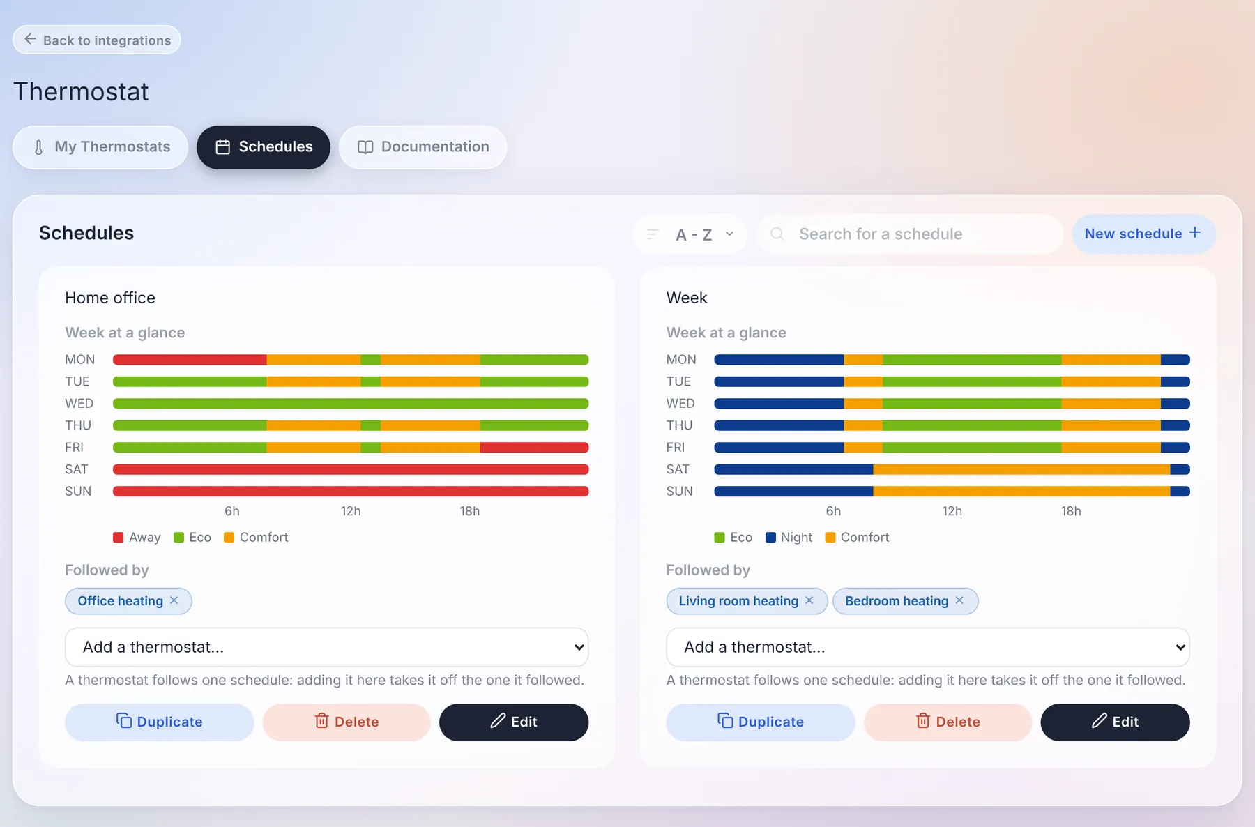

Weekly schedules, per house​
The schedules belong to a house. With two houses, each has its own "Week", and a thermostat can only follow a schedule of its own house.
The schedules of the house: a view of the week, and the thermostats following each of them

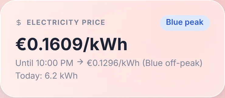

A new Electricity price widget shows the current price, the current tier, until when it applies and the next price, as well as today's consumption.
The electricity price widget: the current price, until when it applies, and the next one

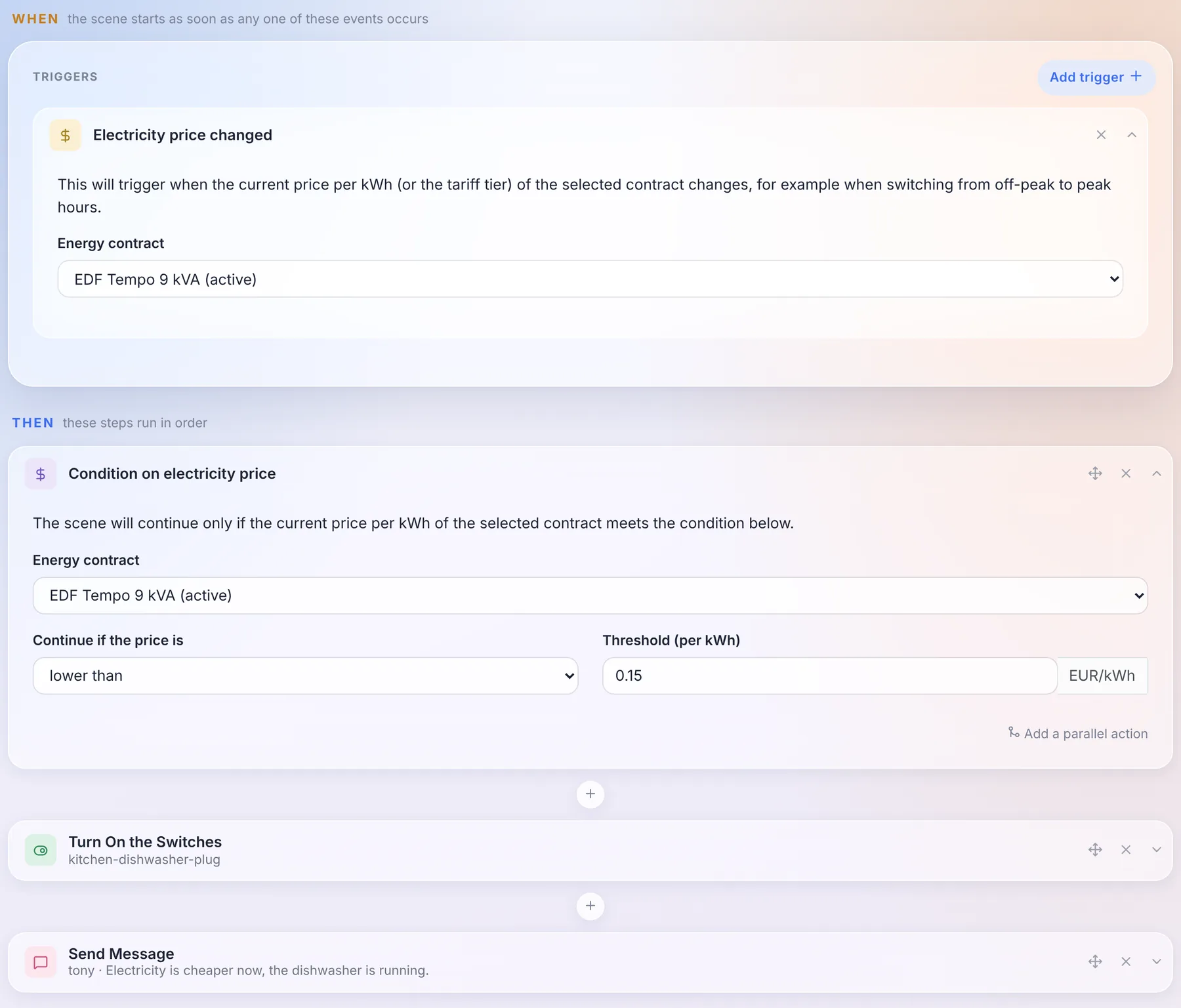

And because the price is now known by Gladys at every moment, scenes can use it: an "Electricity price changed" trigger, and a "Condition on electricity price" action. Starting the dishwasher when electricity gets cheaper takes three blocks:
A scene that starts the dishwasher as soon as the price drops below €0.15/kWh

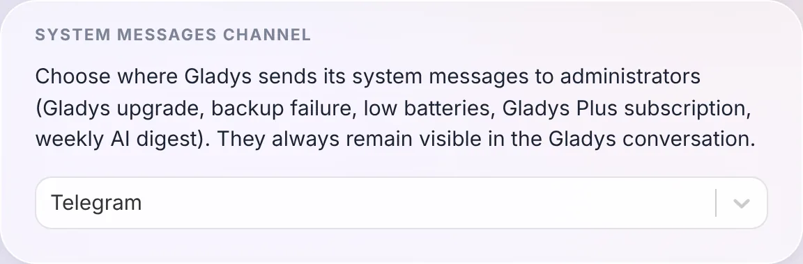

Gladys sends messages to administrators on its own: an update, a failed backup, low batteries, the Gladys Plus subscription, the weekly AI digest. Until now, they went to every messaging channel you had configured.
The new system messages channel setting
You now choose the channel in Settings / System: all of them, Telegram only, or the Gladys conversation only. They always stay visible in the Gladys conversation anyway.

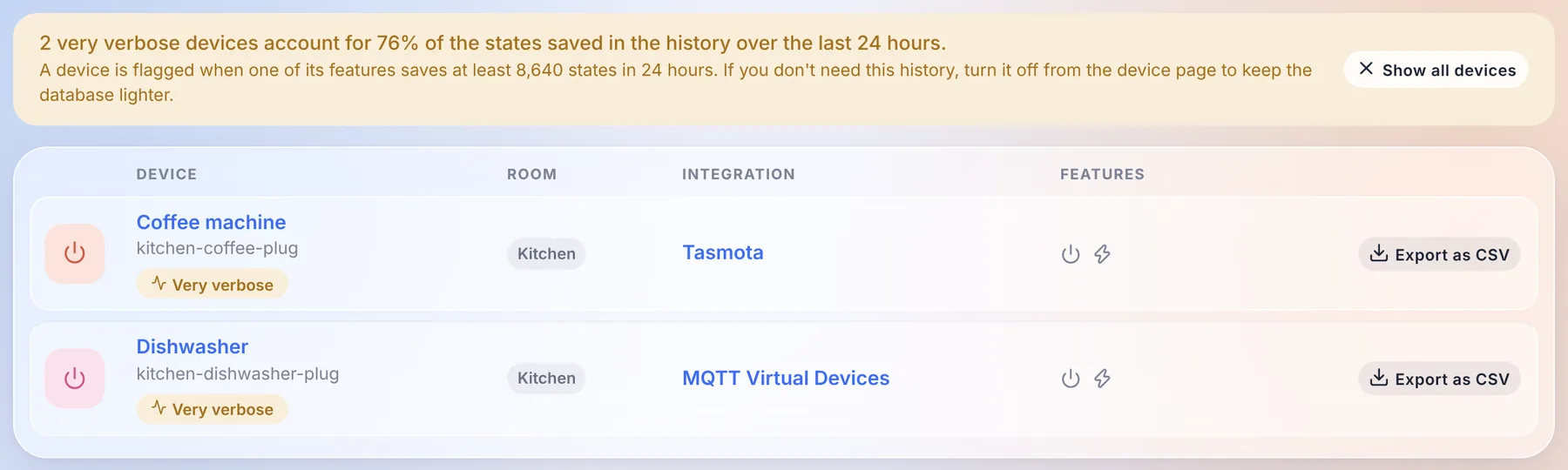

Some devices send a value every few seconds. A smart plug reporting its power ten times a minute, kept forever in the history, ends up weighing more than the rest of the house combined.
The devices page flags the very verbose devices, with their share of the history
The devices page now flags them: a banner tells you which share of the history they represent over the last 24 hours, a filter shows only them, and each device page displays the size of the history of each feature. If you don't need that history, disable it from the device page, and your database will thank you.
